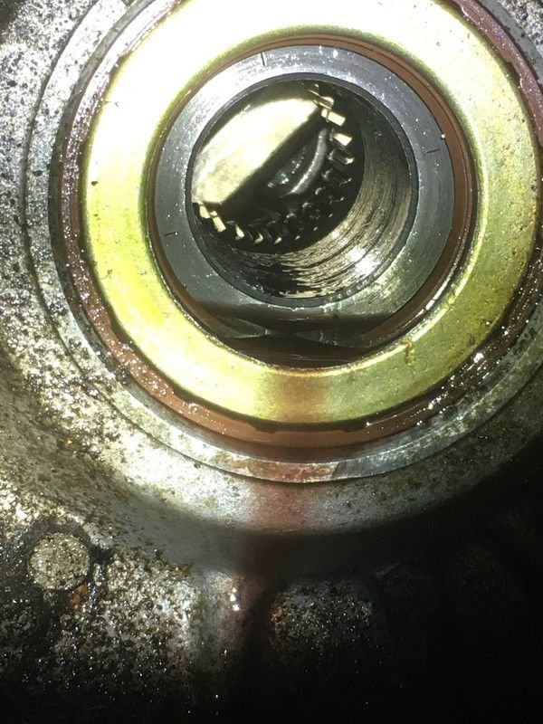

So upon inspecting the axle, there is a bushing surface on the inner end of the axle, just outbound of the splines that fit into the diff. This bushing surface seems to be worn out causing the shaft play.
I'm looking around to try and figure out if this is servicable, hopefully the axle's bushing male OD is worn down, so a new axle could fit into there more snugly, but its hard to say for sure.
I'm having a hard time finding information of renewing the female bushing inside the diff, if this is possible? or if the axle's male OD surface is what wears.
Maybe if someone has a spare drivers side axle laying around they could measure the OD of this bushing surface for comparison?
EDIT: the bushing surface inside the diff is all gouged up, IDK how this happened but idk how it can be cleveryly repaired with some sort of insert maybe 🤔

Old Jan 3, 2021 | 03:09 PM
spiffy926's Avatar
Joined: Aug 2014
Angry
Heres what it looks like apparently theres no sleeve no nothing to do other than to take the transmission out.
I bet someone who is clever and determined enough could find a way to broach the hole oversized and press in a new bushing but I've decided to throw in the towel on this one.
Frankly I'm kind of disappointed in Volvo for a ****ty design... in the angle gears they use, they have replaceable sleeves for when these wear out, but not in the transaxles apparently. Or at least no one is talking about it.
