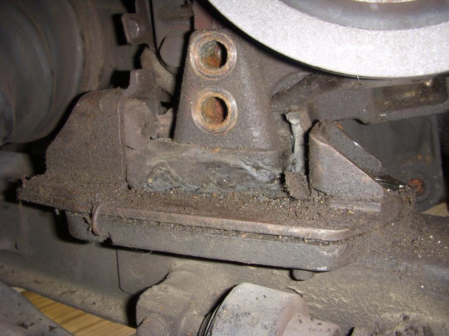

Thumbs up front mount in
Well the front mount was totaled, completely destroyed. Removal was a bit tricky on the bolt to frame on the back side. After a bit of work and a 17mm wrench and a pipe for leverage the bolt loosened and screwed right out. The motor had to be raised quite a bit to fit the new mount in and line up the bolt holes. This took out most of the undercarriage noise. i had also replaced the top motor mount.
on to the front brake rotors and pads, I got ceramic pads and front rotors, and 7mm allen socket for $ 115.00
