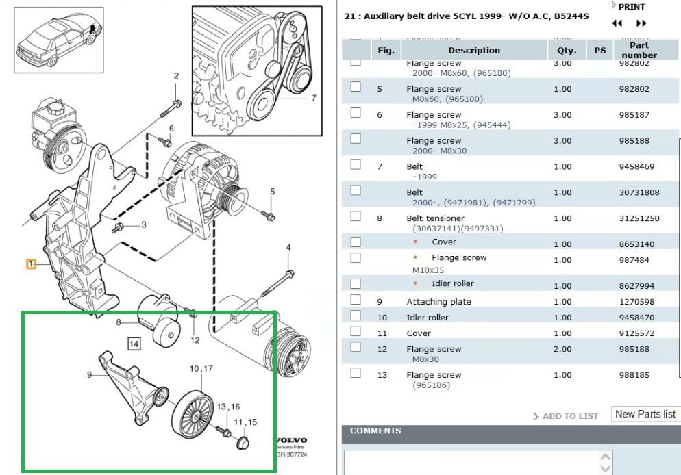

Sounds like your compressor seized. A "recharge" is not going to help. A replacement compressor will.
There is a part number for an idler pulley used on cars that don't have ac installed. That way a replacement compressor won't be needed - just a pulley and a shorter belt.
I'll try to find the part number -

Don't recharge it - not relevant. Look to see if the pully bearing is good. If the compressor pulley spins freely, you need to unplug the compressor clutch and put a belt back on.
Old Apr 29, 2024 | 09:43 AM
Here's what you need to convert it cheaply - don't know where you will find a 1270598 and a pulley
