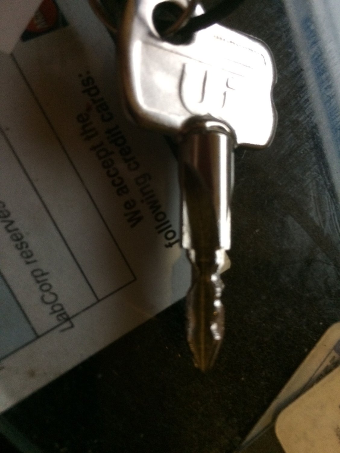

here is a shot of the dual axis key. I do not yet have a manual for this car that would probably answer my questions.
