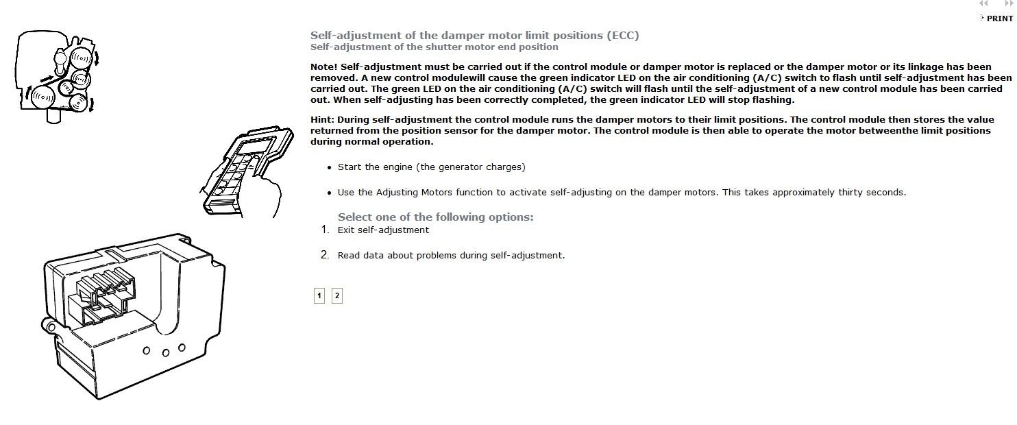

What year is your car? 97-98 are different from 99-00. You might have a bad blend door motor or ecc control unit. You could try setting both temps on full hot for a minute, then both on full cold for a minute - then return to you requested temp - If that does not help -
To calibrate a 97-98 uses this procedure ( with the old volvo scan tool, or equivalent ) 99+ uses VIDA

Thanks for the suggestion, I have a 2000. So I attempted that and now sadly both vents are now stuck blowing only cold lol. Progress non the less but not so good for the winter months ahead 😀
