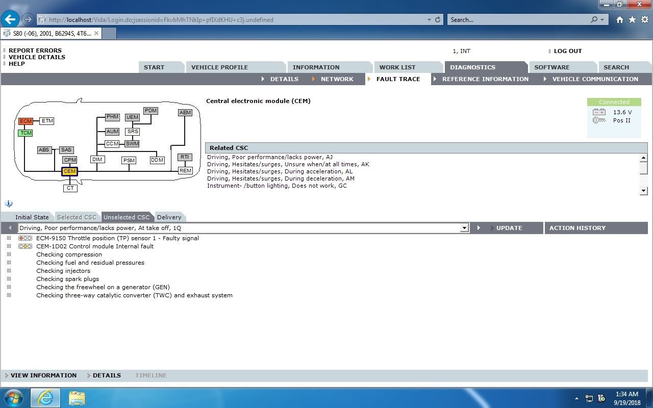

Updating the thread..
I went ahead and purchased the DICE module + downloaded a vmware vida.... Finally got it to work and heres what i found.
To fix the ECM-9150 Faulty TP signal can i do the contactless TP sensor mod?

Update 10-2-18
Welp...
Replaced the TP Sensor with the Sacer contactless sensor and so far the car drives fine.
The delta between the 2 sensors is about .69degrees. so not much difference. The car feels different however.. Upon start up the idle would be around 1000rpm or below for cold start.. and sometimes when im gassing from a standstill itll have a little surge from the beginning before smoothening out.
Also when graphing out the throttle position sensor i always see a dip on the line graph every second when idling.
