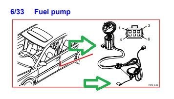

There are two level sensors, one on each side of the tank. One is built into the fuel pump and one on the passenger side. Which one did you replace? (I always thought one side did 0-1/2 and the other measured 1/2 to full - but I never personally replaced one of those pumps - always had one of my techs do them -

Thanks hoonk!! Much appreciated, this is what I needed I think our issue is on the pump side, hopefully now we can figure it out

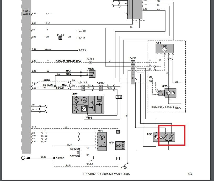

Did you check the wiring harness between the sending unit and the gauge? Sometimes a simple connection issue can cause a dead gauge, even if everything looks connected. Also, a bad ground could be the culprit. Before you pull the pump again, I'd trace that wiring carefully.
