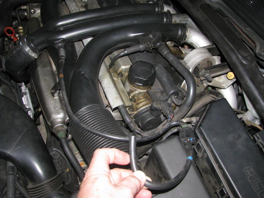

In my '02 S80 T6, I have discovered a hose that is not hooked up and it is not obvious where it goes. I have a attached a picture. Can someone smarter than me give me some clue(s) as to where it is supposed to be hooked up? Thanks...Skooter.

That looks like the turbo control valve. Look for a fitting under the accordion hose area to connect the vacuum hose to.

Yes that should go under the hose buy the other 2 hoses that are under there.

I'll give that a try and let you know if I can figure it out based on your advise. Thanks. Skooter

Ok...that was easy. Found it and hooked it up. Many thanks!!!!
