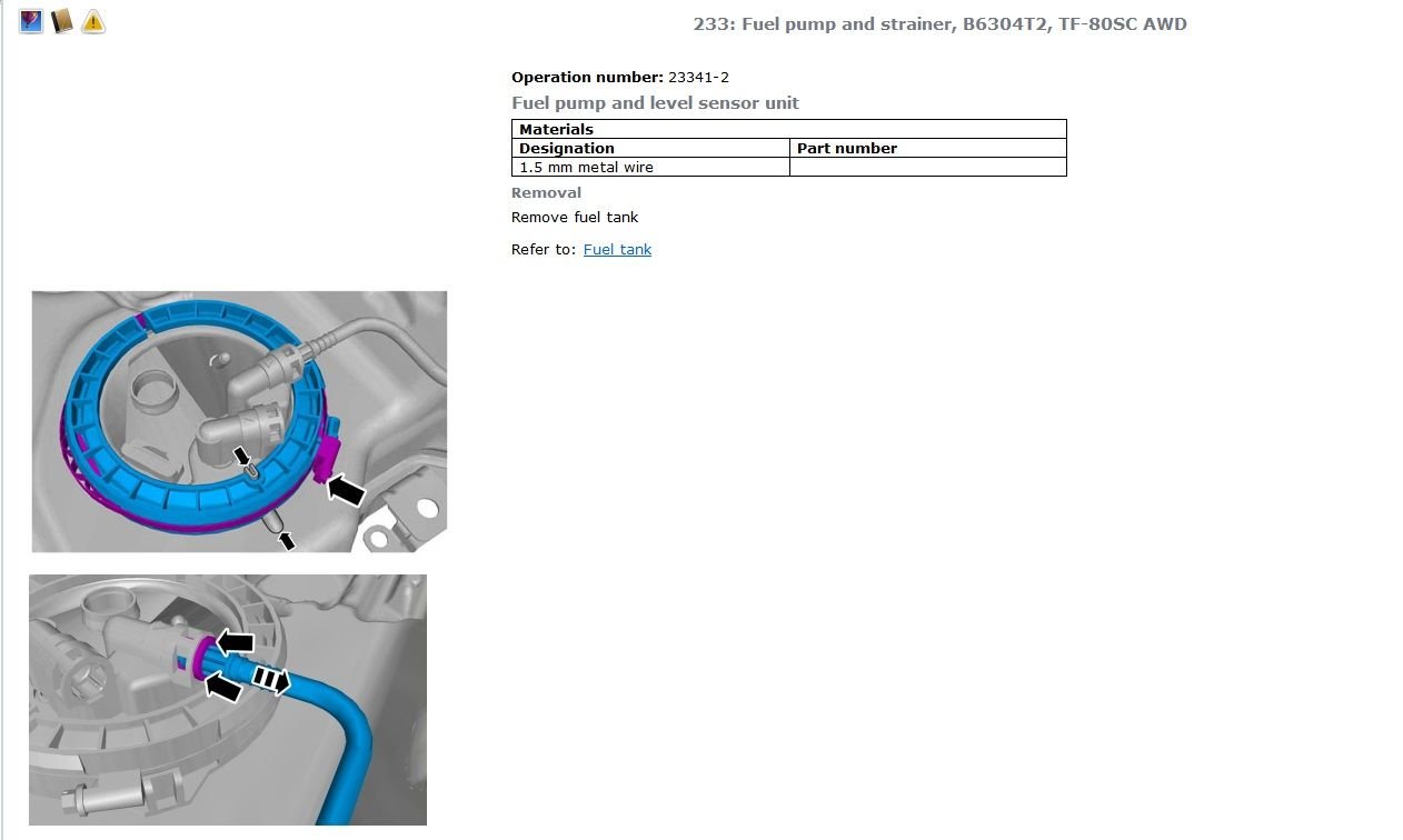

Volvo's instructions for fuel pump replacement start with the words "Remove fuel tank"
And Volvo shows a special tool (tube) that fits in the filler neck to siphon the fuel out of the tank. So you might want to actually diagnose the car rather than just guessing and replacing a part that's difficult to get out - and might not fix your car.
It's going to be pretty hard to remove a full tank (going to be really heavy) would be easiest with a jacking platform (most larger shops have them for dropping various things from the bottom of cars)
