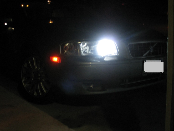

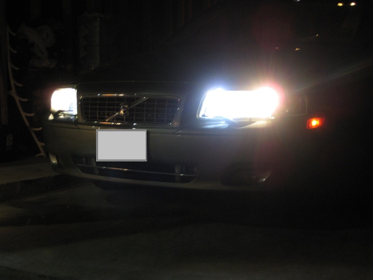

LED parking lights..They are 38 T10 LED. Very bright!!

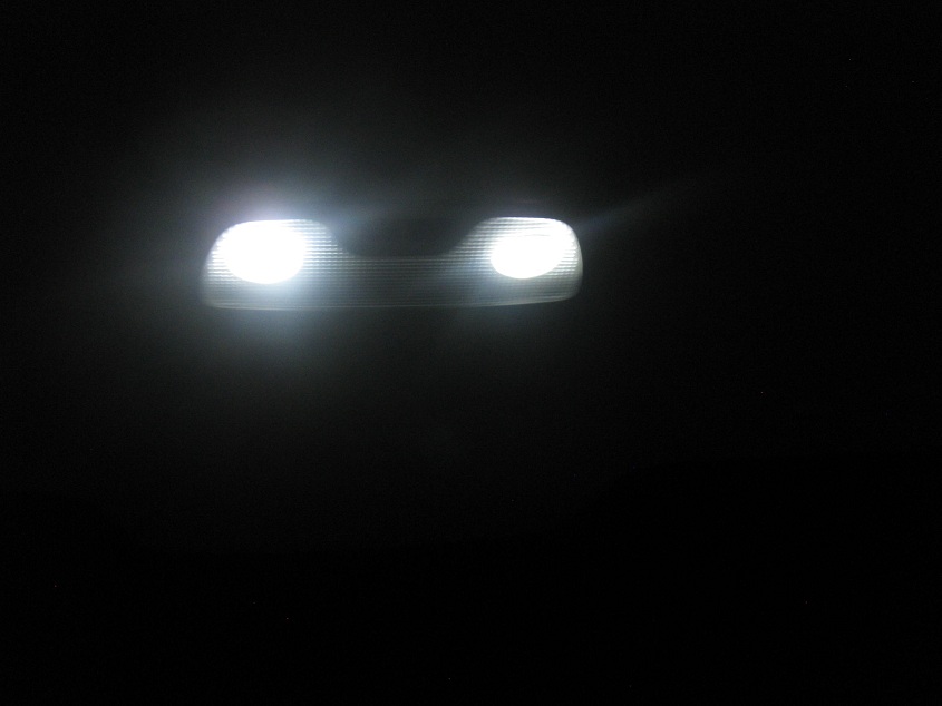

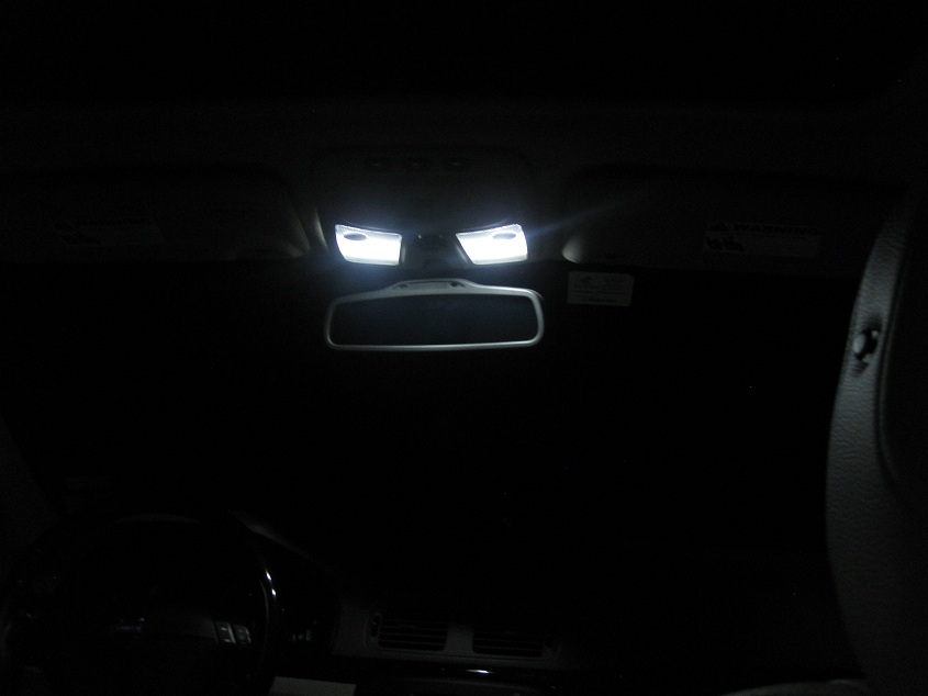

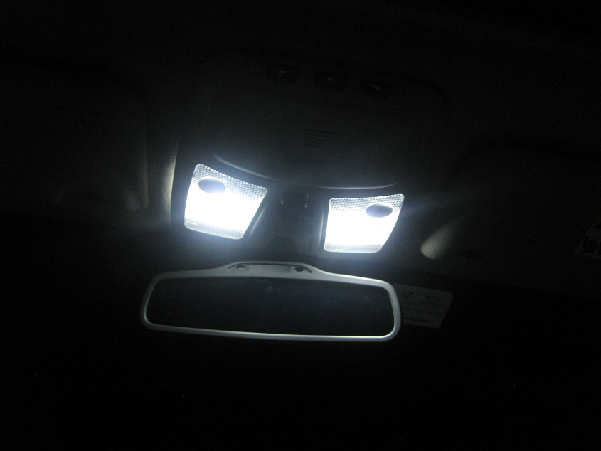

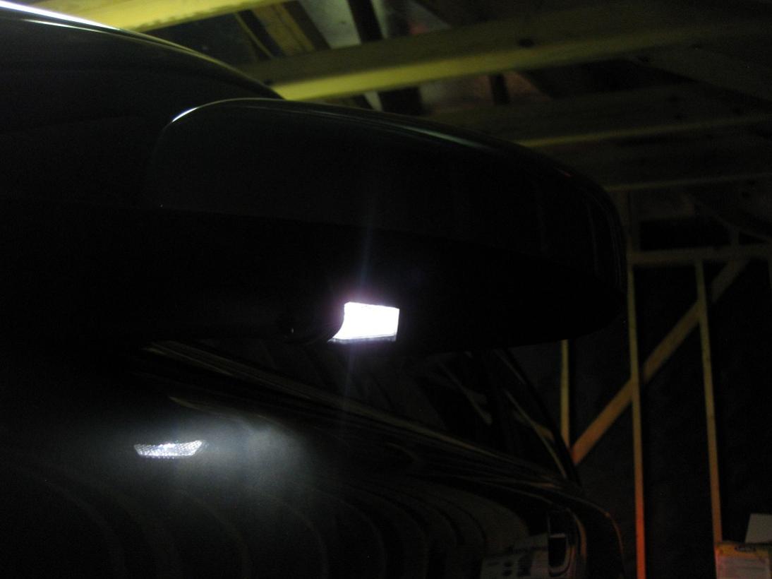

did an all interior to LED.

Nice shots. What type of LEDs did you use the the dome lights.

its called festoon LED. Now here are few IMP things one should note. I learned it - you can say it "the hard way"
1) For front and rear domes/reading/map lights (only) one should ONLY get error free LED or canbus LED or if you are buying a regular (not error free) then make sure you solder resistor to them because the LED will stay on lightly dim when the doors are unlocked or when the driving the car. But will go off only when the car is locked.
So now this is up to preference some people want to have that dim lit on. Its not very bright at all. i have left that dimness only for the back dome lights.
2) you are suppose to get 42mm Festoon size led. But i have right now 36mm size. And that does fit too however the metal prongs on the dome that holds the bulbs, jsut make sure that the prongs are close together. You can either do it by hand (might be tight) or use a pliers. Make sure you tighten the prongs just enough to insert and hold the shorter 36mm size. For 42 mm you dont need to adjust all these. But i found that 36mm are much cheaper than 42mm.
3) for door/front footwell you dont need error free type LED. And for front footwells area you again need festoon led and for rear doors its T-10 LED.
4) the glove box requires BA9s LED
5) the trunk is similar to front footwell which is 36mm LED
6) the reverse light require BA15s/1156 LED. I ordered that too and waiting for it arrive. Coming from China so it might take a month .
here is removal of led..that guy also shows how to remove rear,puddle and footwell led too. So check his other videos
anyways let me know if you have any ques.

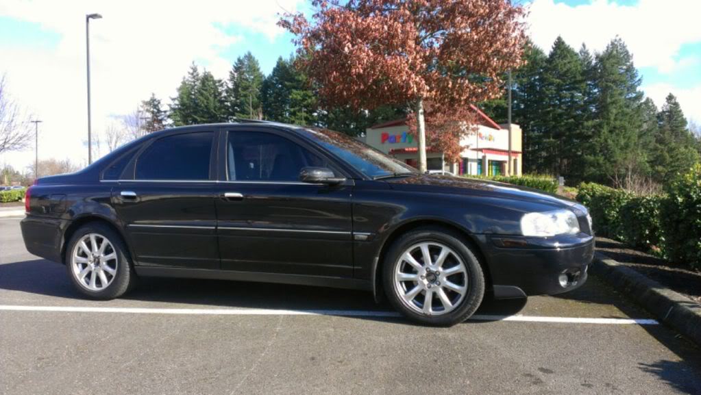

Hi names Michael I'm 25, live in WA. I am no stranger to customizing cars but I'm new to Volvo the wife just picked out her new to her 2005 s80 black on black t5 auto with 68k she has already given me the list of modifications she would like having a hard time finding some does the s80 share parts with any other model? Anyways here's the car when she let's me have it for a day I'll be sure to get more pics

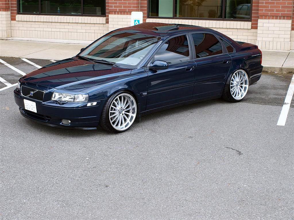

Here's an image of the look she is kind of wanting not as low though I'm having a hard time finding the (eyebrows) for the headlights this car has on it
