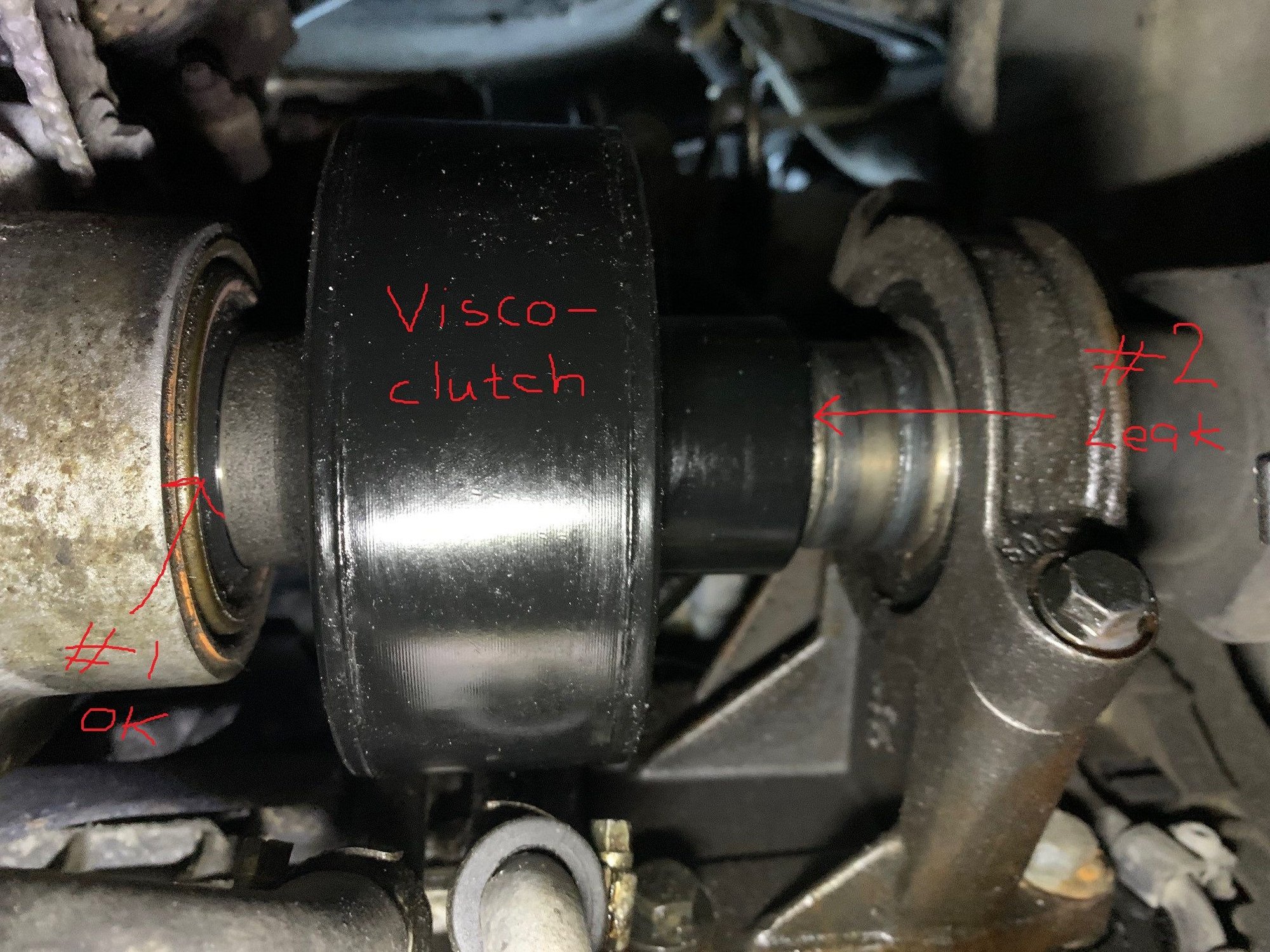

The car is a Volvo S80 T6 '99 2WD. It is one of the few ones from the years 99 and 00 that has a viscous clutch. There is no problem with the car (no shudder nor slip) except that it leaks a bit of transmission fluid. I plan to replace the seal marked with #2 in the attached picture. I believe it is Volvo part # 8636206. What I'm not sure about is how to separate the viscous clutch (the black thing in the picture) from the driveshaft. Moreover it is not clear to me how it is lubricated. It leaks transmission fluid so my guess would be that it is supplied with ATF from the transmission via the driveshaft somehow.
Anyone with experience of such a job?

Thanks a lot for your help guys. I learned that the driveshaft can be tapped out from the visocous coupling in the link that you posted to the other forum. Thanks also for the good instruction on how to replace the seal. I will attempt it without the special tool referenced in the instruction. I think I will wait until the spring to do this job as I don't have a garage to work in. The leak is minor so I can manage until then by topping up the transmission fluid. I will update you once I have a go at this.

So I finally had a go at this job. Some notes that may help others:
The Volvo dealer (at least in Sweden) couldn't say which of the two sealing rings was the right one for my car. They blamed their data system and that it only goes back to the year 2000 and my car is a 1999. In my case the early 42 mm version (part 8636206) was the correct part. I suspect that they quite early changed the design because it was inherently bad and typically leaked. Unfortunately this older part is no longer supplied by Volvo. Luckily I was able to source an original part from a third party.
The removal and replacement went well thanks to you guys and hoonk's excellent instruction in particular. The vicous clutch is just held with a retaining ring and can easily be separated from the drive shaft by tapping it out (small amount of force needed). The seal itself was a bit of a pain to get out but could be done according to hoonk's guide (careful not to pry against the needle bearings and damage them). I did not have the Volvo seal installation tool but I found that a 30 mm socket was a perfect fit to tap in the new seal.
A picture of the viscous clutch with the original seal:
Viscous clutch with original seal (42 mm)
I have now driven some 1000 km since the seal replacement. No more oil leaks. Thanks Volvo forums!
