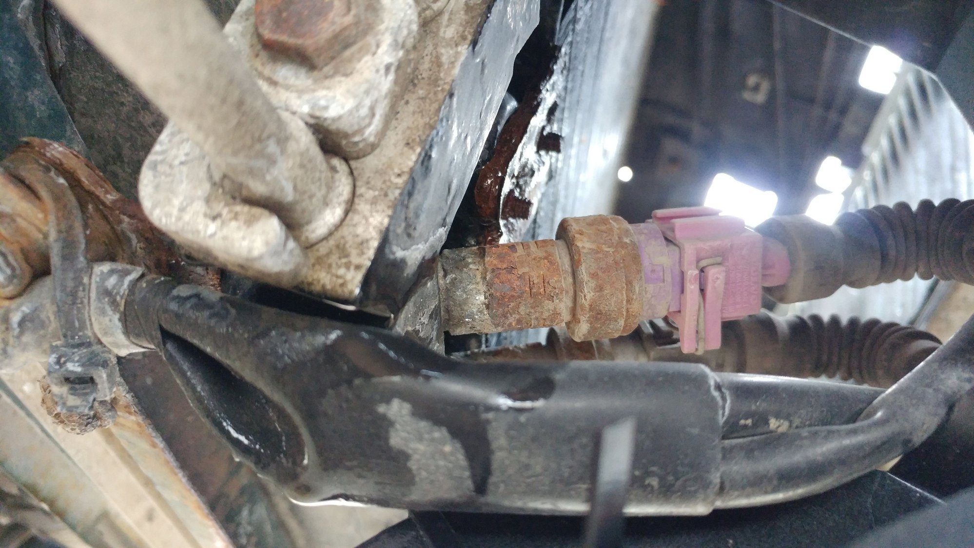

I engine compartment was very clean recent steamed or shampooed prior to me purchasing the car. Everything looked clear and unobstructed. I noticed the rubber flaps on the one side of the rad. It says on the rad cap to use Volvo coolant im not sure if that whats in there i doubt it theres green coolant currently in the reservoir When i ended my 17 hour drive there was a coolant patch on the driveway the size of a basket ball i took the pic from underneith looking up

The vehicle appears to be very rusty underneath. That is a red flag.
