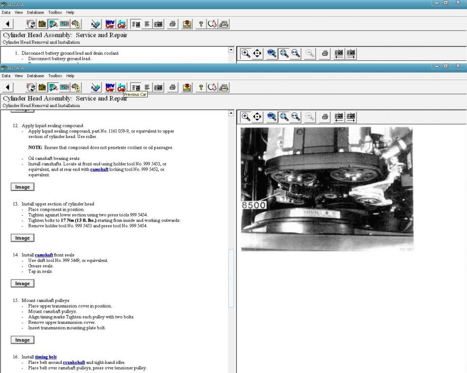

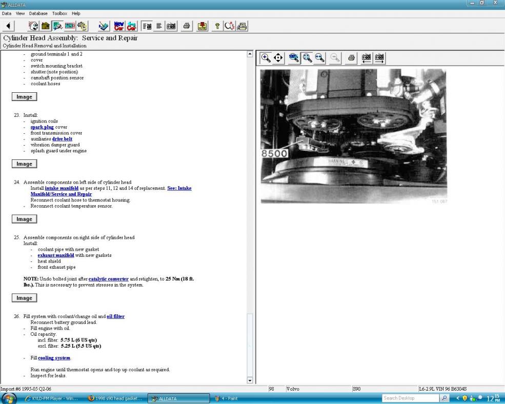

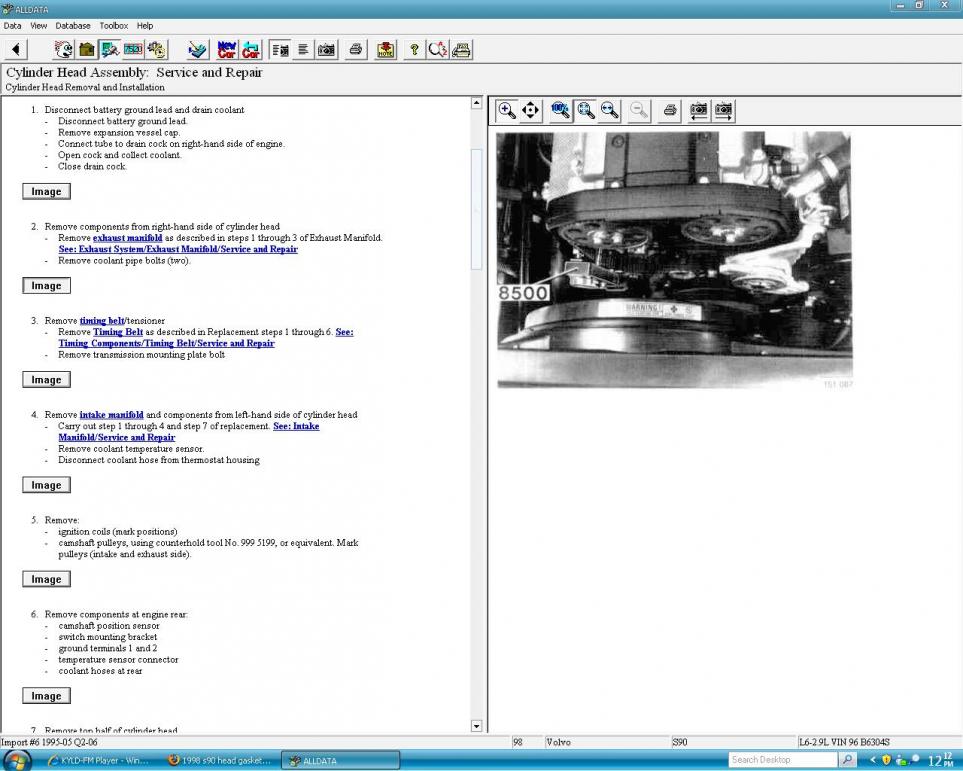

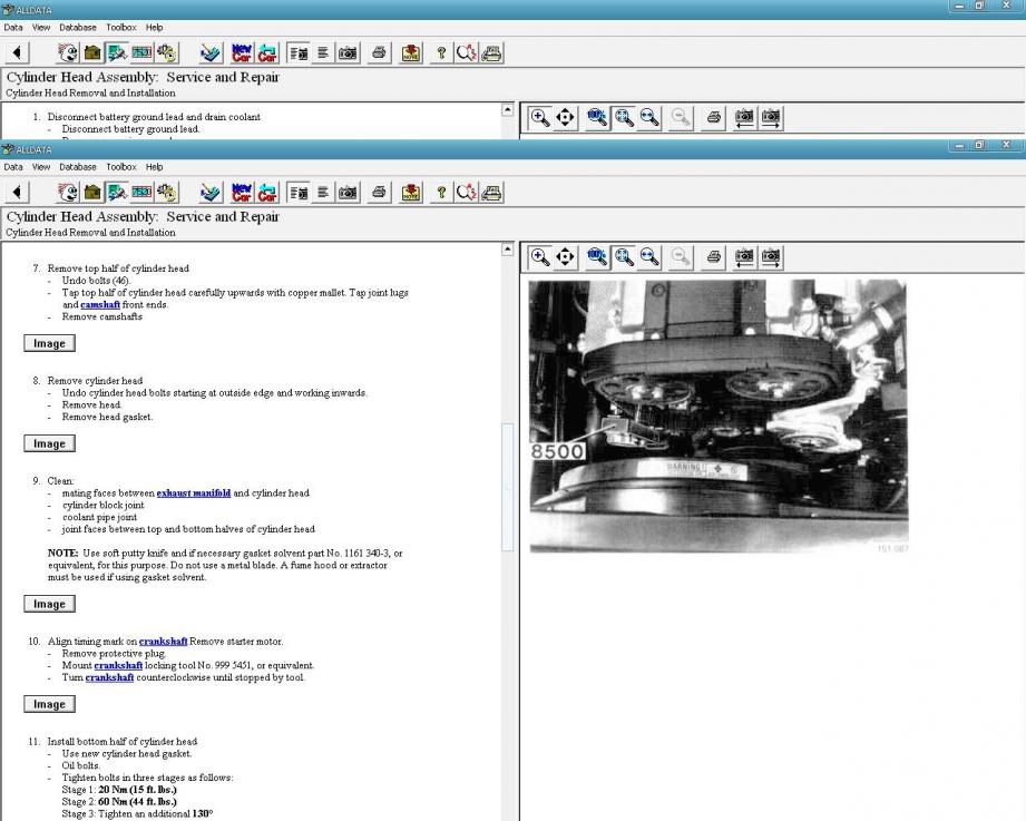

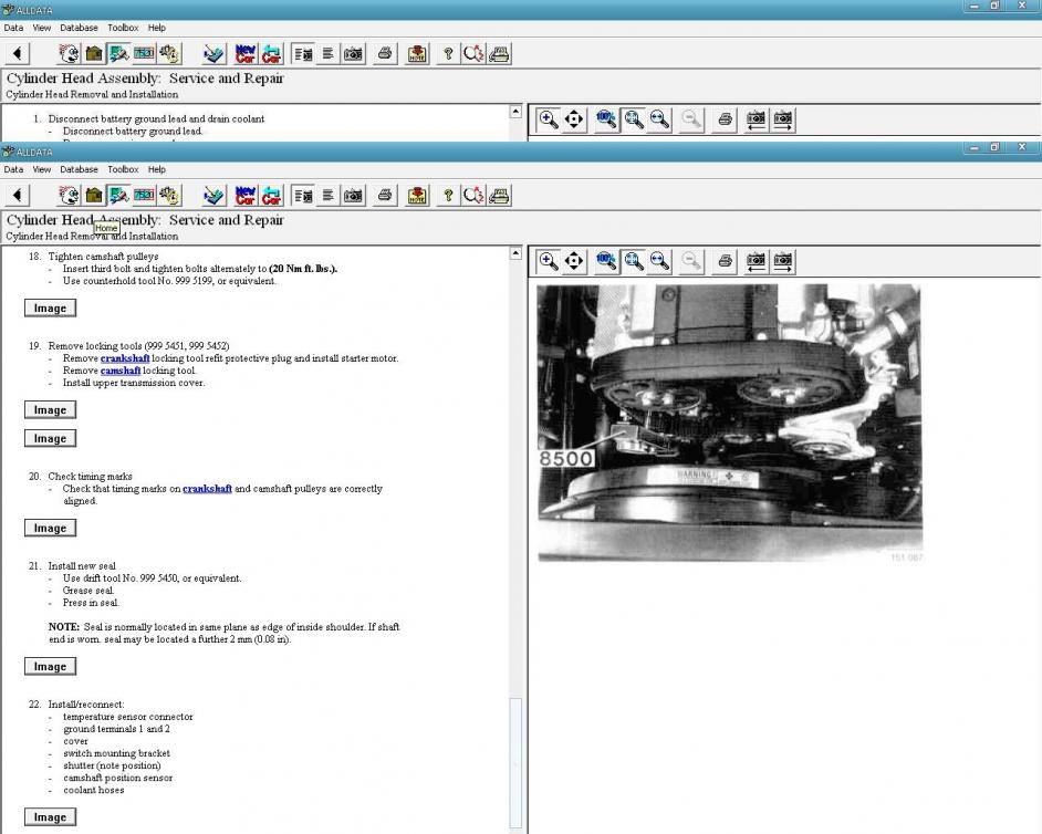

hope this helps
Attached Thumbnails 1998 s90 head gasket replacment-1.jpg   1998 s90 head gasket replacment-2.jpg   1998 s90 head gasket replacment-3.jpg   1998 s90 head gasket replacment-4.jpg   1998 s90 head gasket replacment-5.jpg
