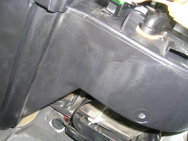

Default where is the valve?
I am pretty sure the recirculate one is the one that is bad bit I can't find a black cover.
I can see one of the vacuum valves but not sure it is the recirculate one. It seems to control the lower vents. If i close it the AC air comes out of it.
Photos are here.
Is this the recirculate control?
http://www.filesavr.com/dscn3477
If not, where is the black cover?

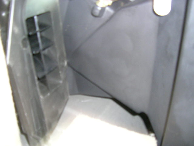

Right side, under dash on the passenger side.
http://www.filesavr.com/dscn3478

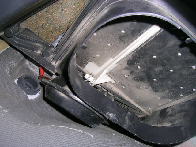

Next to middle console.
http://www.filesavr.com/dscn3479

The first pic is the recirc bellows.

So if that door is push up is it in recirculate mode?
Old Jun 7, 2009 | 03:21 PM
tech's Avatar
Joined: Sep 2004
Posts: 36,349
Likes: 46
Yes the door up is recirc mode. Door down fresh air mode.
