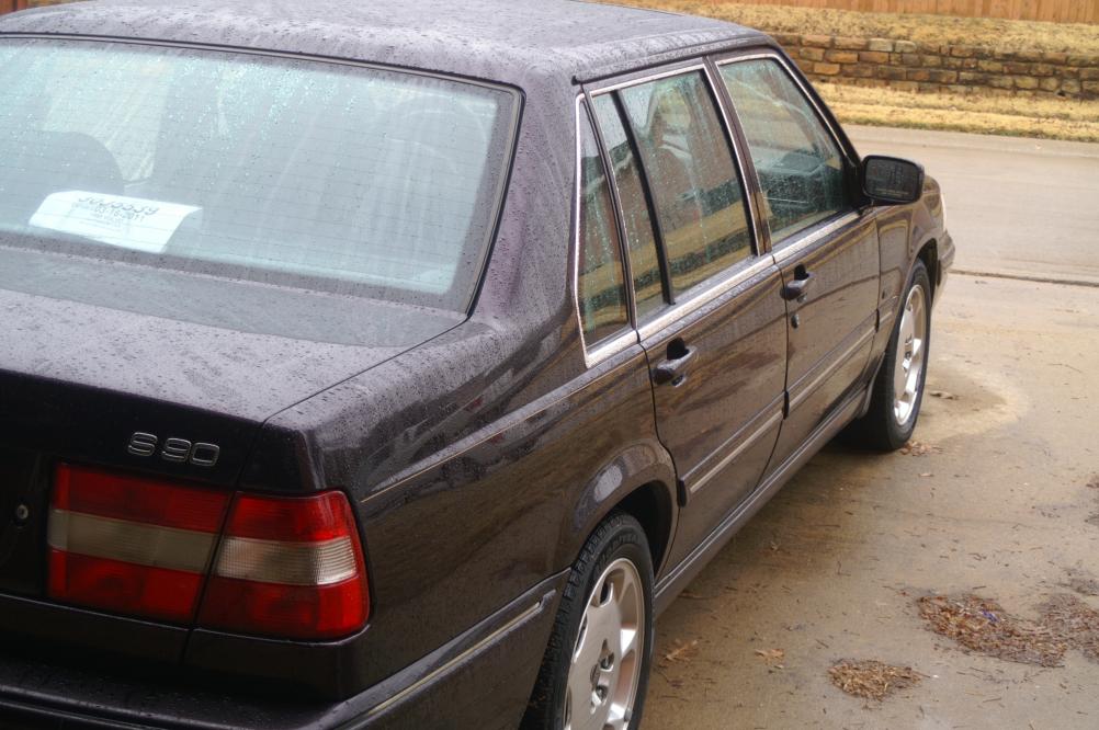

I have a 98 S90 in great condition. A couple of small issues that I would like to see if i can fix:
The clock doesn't work
The radio reception is not great or consistent
The fog lamps don't work
Help?
I love the car, It is the Blackberry Pearl.
