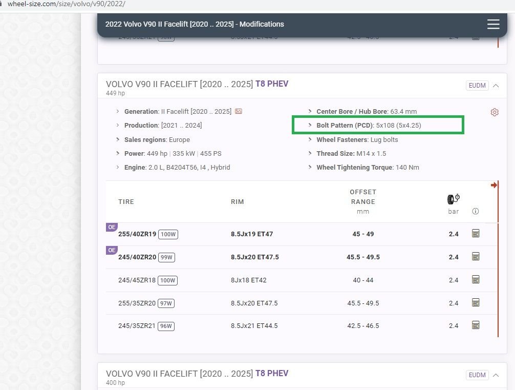

Following a minor accident, I must change a rim on my V90 T8. I noticed many values ​​on the current rims, but one of them I miss: current rims are Borbet BLX 8.5x20 ETA 45 72.5 5x???. I read a value LX108 on the rim: does this mean that the center distance is 5x108mm? Who can confirm the center distance for a V90? I can provide pictures if needed...

5x108 is your bolt pattern - common on many (5 lug bolt or nut) Volvos for many years. Are you asking about the offset?

Many many thanks! Even Volvo's Customer Support wasn't able to answer this question! 🤦‍♂️
