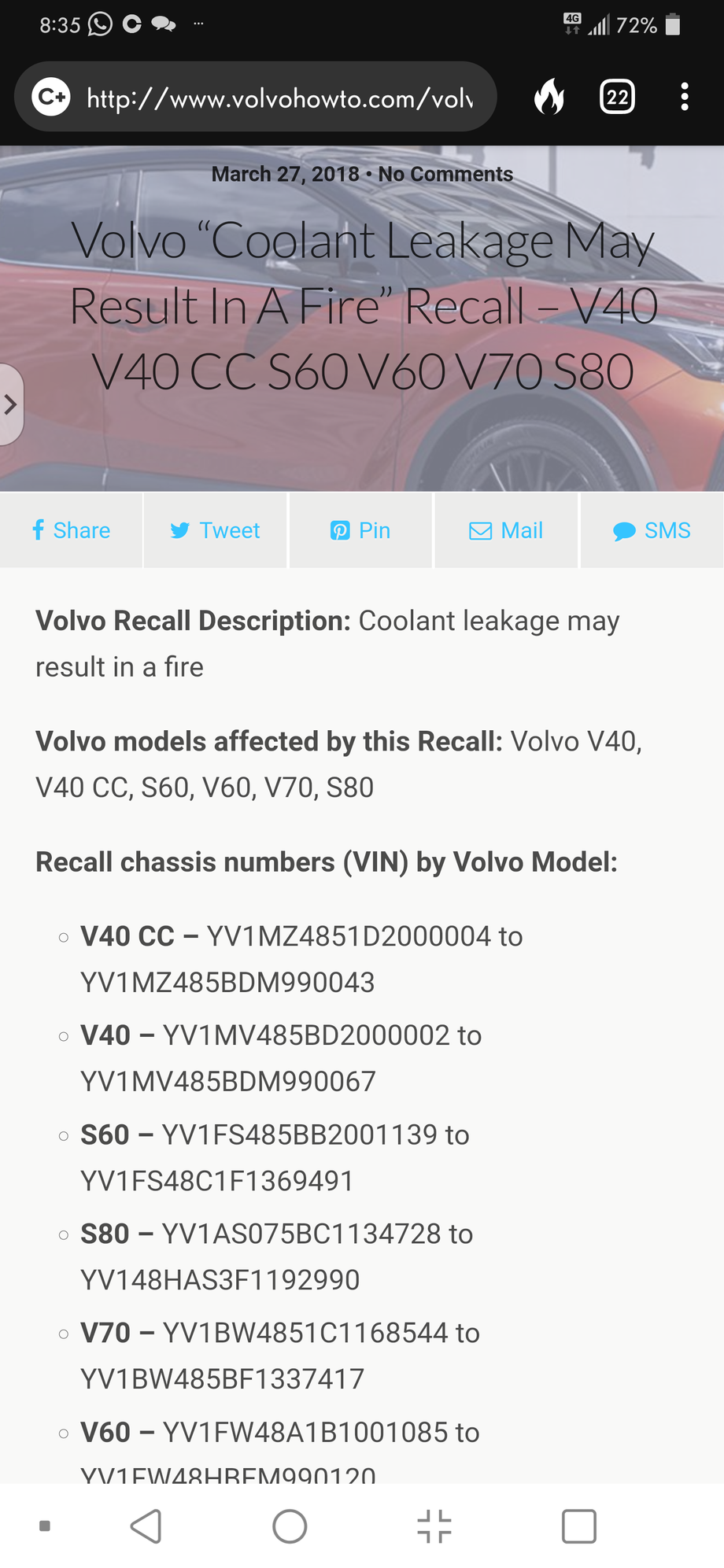

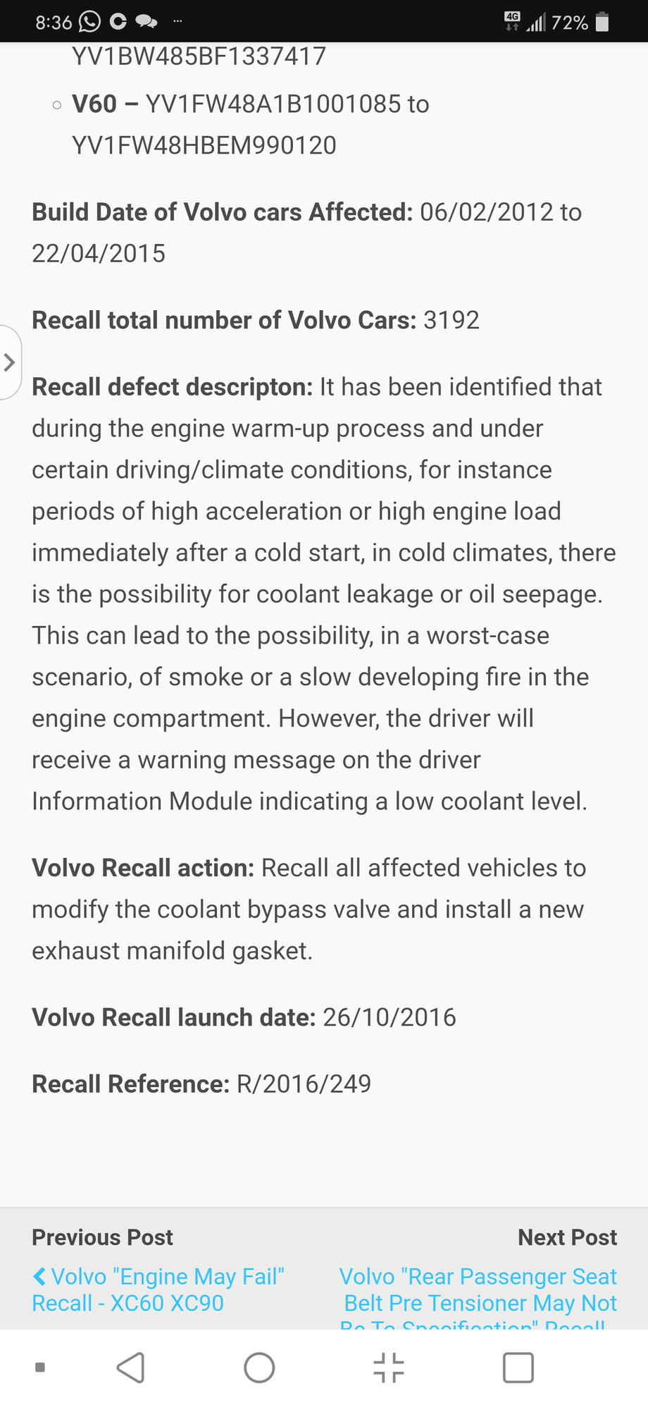

Tomorow im taking the car to the dealership but i managed to visit a web page (volvohowto) and in one post they report a recall from 2018 affecting several models..They report that there could be a coolant leakage and that the coolant bypass valve should be modified and the exhaust manifold gasket changed...
I need your help to determine if my car is affected by this recall..my vin number is YV1MZ485BE2027033..i cant seem to determine the sequence
The cars affected and a description of the problem below..
If you can offer a bit of insight..anything is welcomed..
