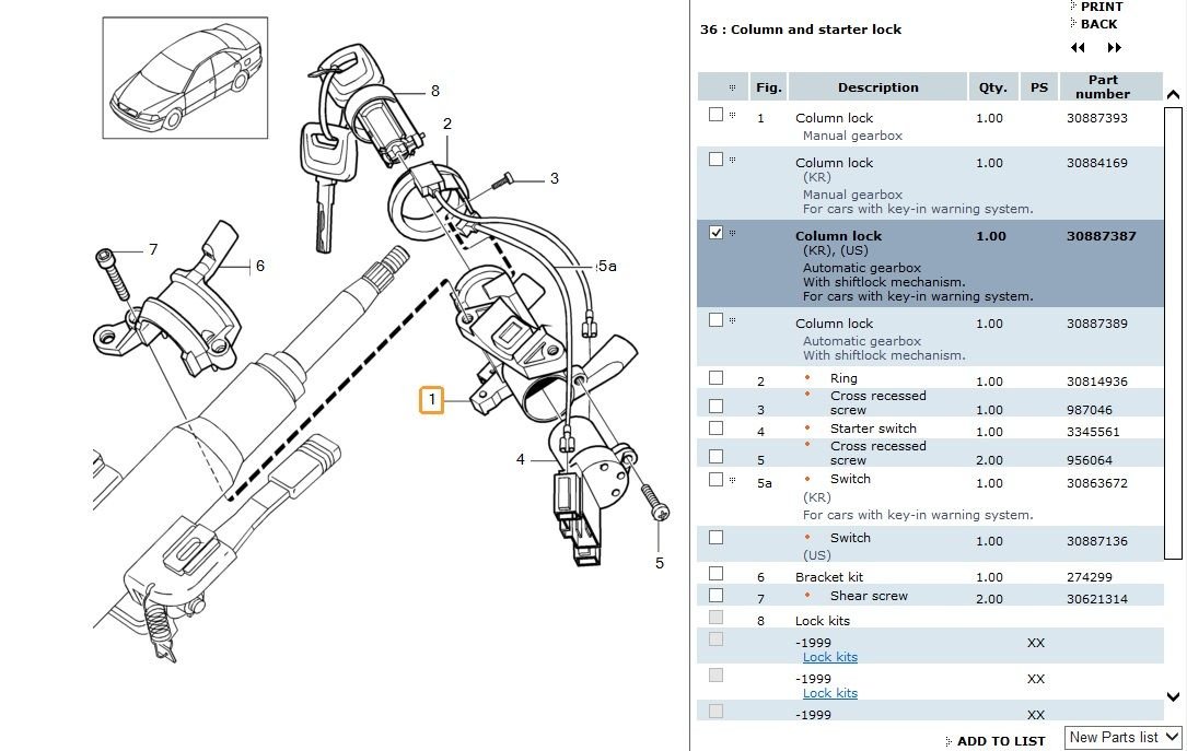

I've had to replace many steering column locks that refuse to turn - The s/v40 column locks in that year range fail like the 01-07 v/xc70/s60 cars - but the ignition tumbler is removable (it is not in the other cars) The normal failure is the key won't turn to the start position.

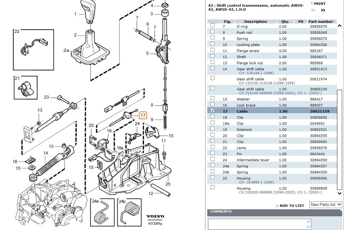

Can't remember if there is a cable from the shifter to the column lock (#17?)- (like the other cars in that year range) - but if that cable fails to move when shifter is in park - the key can't be turned back all the way and removed.
