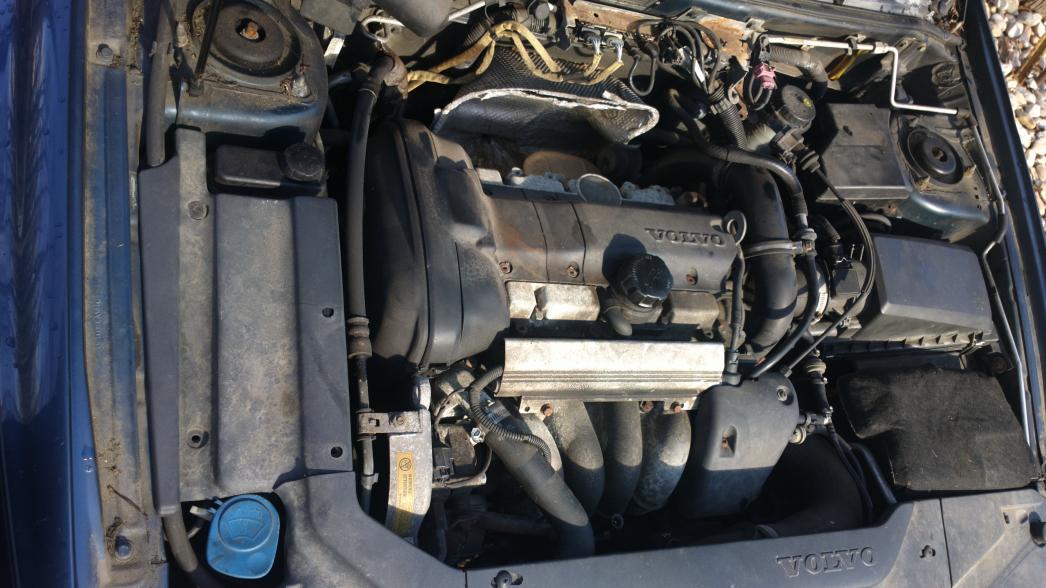

Here's my engine right now:
2014-11-28-1217
Also, there's something like an aluminum tray behind my engine...what is that?

I also have a 2000 V40 that I bought for my kids to drive a couple of years ago. I have whipped it into shape so will do my best to help you.
The metal tray is a heat shield that protects the firewall from heat from the turbo.
I can't tell much from your video but I'm not sure why you think the throttle body is the place to start.

OK, you have some work to do.
P0705 and P1618. This is your PNP switch. I recently repaired mine. Made some comments on this repair here. Repair is tricky and I'd recommend you just replace the PNP switch with a new Volvo part.
P0507. I'd start by cleaning the throttle body. It's just to the left of the battery, under the black plastic cover and under the fuel pressure sensor. Follow the hard black plastic hose from the top of the intercooler and you will find it. If that doesn't fix the P0507, next clean or replace your IAC (idle air control). Also check the small 1" diameter (or so) rubber hose near the throttle body that connects to the top of the intercooler. It has been known to break causing various idle and running issues. If you find this hose broken replace it first as some of the other codes may be caused by this broken hose.
P0300. Replace the spark plugs with Volvo plugs or their direct equivalent (Denso K20PRU). Don't be tempted to install any kind of fancy plugs.
P0014. Probably your VVT solenoid (reset valve) which is on top of the engine under the cover on the passenger side. I think this is probably responsible for the rattle you're hearing at idle. It's possible to clean it though most people just replace it. Start using a high detergency engine oil like Pennzoil Platinum to help clean up your engine.
