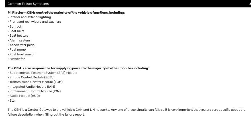

CEMs do suffer from water intrusion on some cars - so that's a possibility (xemodex does not list water intrusion as a common failure on your CEM)

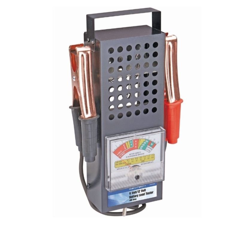

12.4 volts would be the static charge, A load test is when a resistance is applied between the terminals, simulating a large current draw. As in the amount of current a starter might use. The voltage during that test is usually 10.5-11 volts.
Load testers are usually mechanical with a wire wound resister like below -
