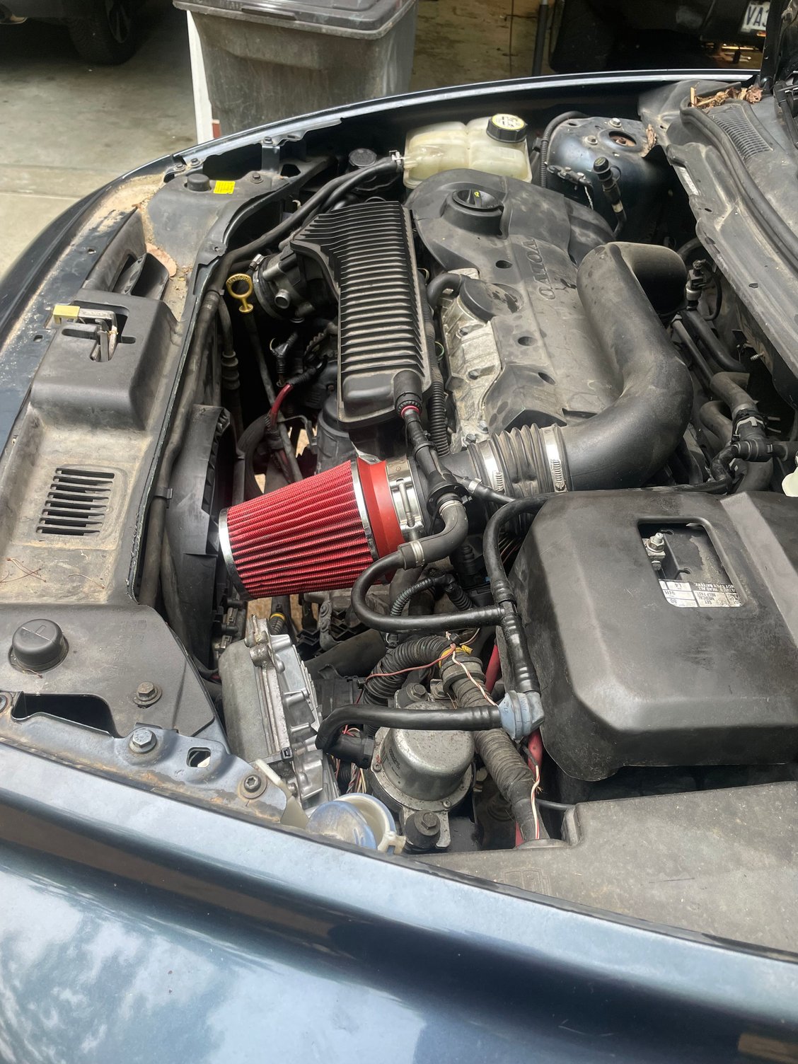

So I’m questioning if the right alternator was put on this car, by previous Indy mechanic.
It was infact too far towards the side wall.
I took about a cm of metal off the shoulder on the upper Carrier arm and opened one of the square mounting blocks on the bottom of the alternator. This moved it towards the block appropriately.
I also deleted the stupid air box that blocked access to everything on the top end.
