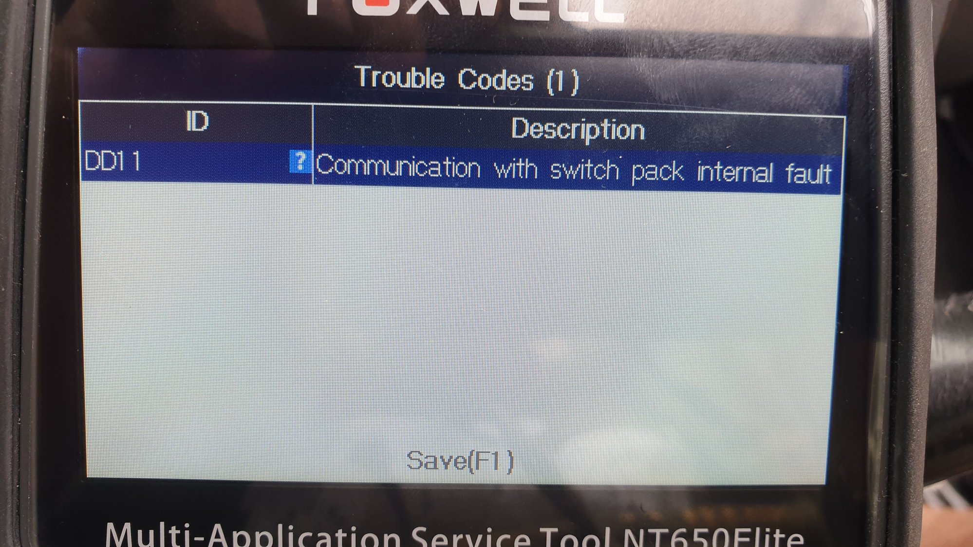

this is the code i am getting, is this the control pack attached to the drivers door behind the panel?
i have back probed the wires going into the back of the door switches and there is power getting there
Thanks
