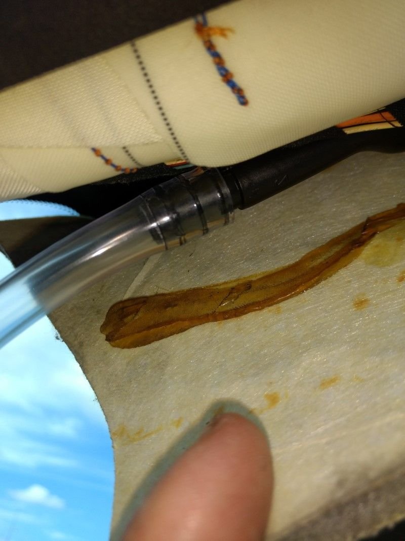

3. Remove the old plastic tube that runs from the sunroof drain down the A pillar. You may want to carefully twist it first to break free of the sunroof male part so that part does not snap. Replace it with the new tube.
4. Run the new tube down the A pillar using the same clips as the old tube. If there is any location where you fear the tube may become compressed, cut a piece of rigid plastic electrical or plumbing pipe whose inner diameter is the same as the outer diameter of the tube, slide it over and position it at the potential crimp-spot, and tape it to not move.
5. Instead of going to the inaccessible sound trap, run the tube down to the floor inside the cabin. It will fit neatly behind the carpet and insulation (consider the rigid cover if there are any potential compression spots)

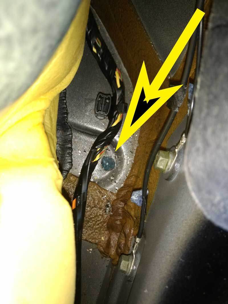

6. Take a drill with a 13mm metal bit and drill a hole in the floor, close to the exit point for the tube. Be careful to not let the drill bit "skate" and damage any of the nearby wires. If in doubt, use a punch first to set where the bit will cut. Also, before drilling look underneath to see where the hole comes out. Do not drill through brake or fuel lines, electrical or anything else you may regret. I found in the place where I drilled, there was a gap in the chassis so I was just drilling through a small bit of sheet metal. Use your eyes and common sense.
To prevent rust, spray the new hole with anti-rust paint and dab on a bit of silicone sealer surrounding the tube
7. Insert tube in the new hole and allow it to extend down to the ground.
