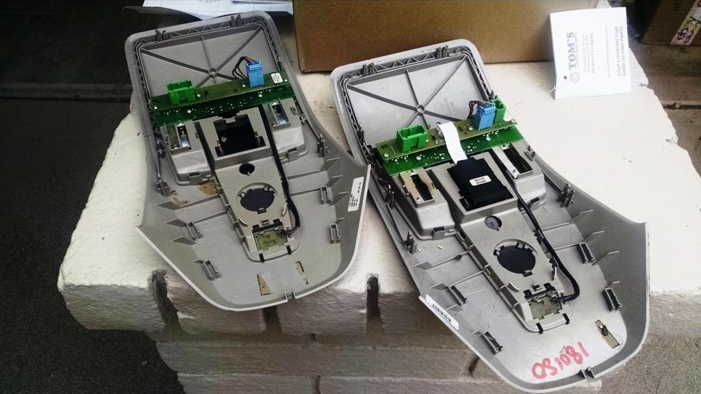

When I bought my 2005 V50, the overhead console was cracked, loose, and looking pretty rough. I went online looking for a cheap replacement, and the only thing close I could find was one that was for a sunroof car (my V50 happily has no sunroof - in Arizona, you try to keep the sun OUT of your car). Being cheap, I ordered it anyway. The old broken one is on the left, and the "new" sunroof panel is on the right...
They're very subtly different colors, but the new color will actually match my upgraded interior better (a future post on that one).
After a bit of work removing the black center panel from the broken panel, and relocating it to the new panel, from which I'd removed the sunroof button. I also scavenged a few other bits, like lower-wattage light bulbs that apparently melt the plastic housing slower...
When I went to install the rebuilt panel, I could see what happened to the old one. The headliner material overlapped some of the slots that the panel's tabs locate into - apparently the previous owner had tried to overcome this impediment by pounding on the poor panel with his fist until most of the tabs were broken and the panel itself was cracked. 60 seconds with a razor knife fixed this problem nicely, and the "new" panel went in like butter.
