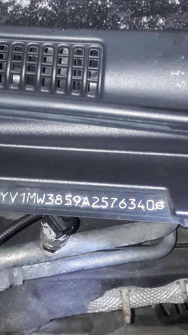

the code can be found on one of the build plates (not sure where on your model) - maybe on the firewall, dashboard or door jamb. Also should be on a sticker on the timing belt cover (passenger side of the engine on the transverse 5s)
The easiest way is to look at the VIN - positions 6 and 7 are a two digit engine code - ie 38 means you have the B5244S4 engine (which is a gas 5 cylinder 2.4 Liter 4th generation NA engine) and a 67 would be the B5254T7 (code for a 5 cyl 2.5L turbo...) I've posted the two digit codes as well as the B codes

Sir , are you talking about this number?

38 means B5244S4 which has a timing belt with maintenance due at 120,000 miles / 10 years w tensioner & idler pulley
