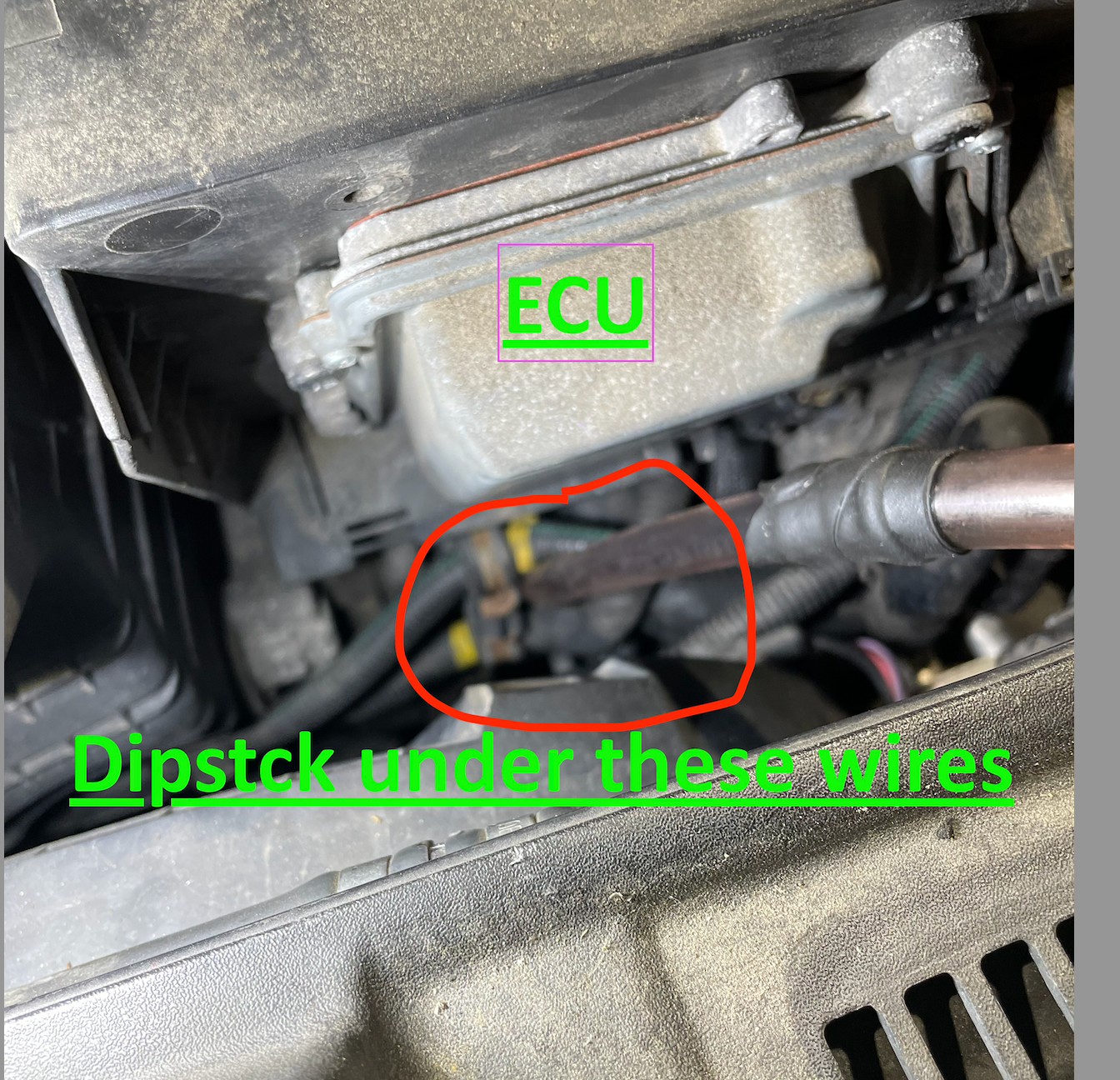

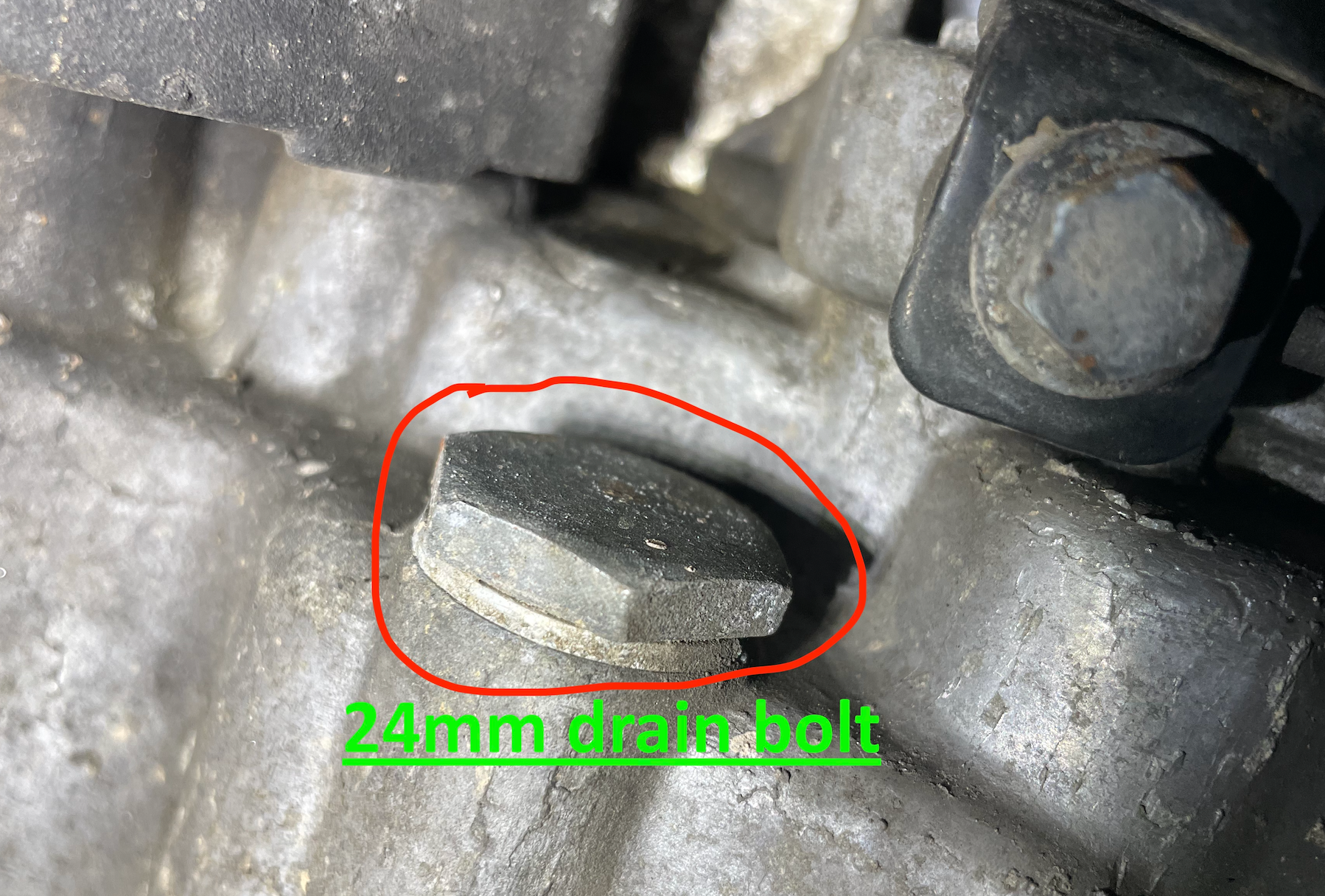

Just did the drain and fill fluid change on my 2007 V50 T5.
It was really easy.
Drained exactly 4 quarts. Refilled it using the dipstick tube.
I bought the FCP Euro Volvo Transmission Service Kit - Aisin 1161540KT2 ($36)
Here is what I found:
  1. You only need to remove the cover of the ECU to gain access to the dipstick tube (for inserting the filler tube/hose).
  2. It is 100 times easier to remove the trans fluid dipstick from underneath the car and insert the filler hose
  3. I used the dipstick to figure out the size of the filler hose that gets inserted into the dipstick tube. Needed two different sizes. In one of the photos you can see how I inserted one into the other and sealed it with tape
PS: Please excuse the typos on the photos.
