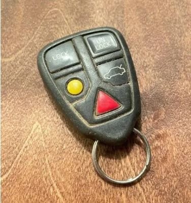

Your switch blade style key - has an immobilizer transponder in it. That signal is picked up by the antenna ring - that's the illuminated ring around where the key is inserted. The transponder has to be within an inch of the antenna to work. If you lost the transponder (example pictured below) - that key WILL NOT start the car. I trust you got BOTH the keys and the valet key when you purchased the car? If not, you will be quoted $600 or so for a replacement key and remote. That includes the key, remote, and programming that can usually only be done at a Volvo Dealer (or anyone else that has a VIDA subscription)
The key is actually 2 separate parts that unbolt from each other. The remote and the key. If your remote still works you just need the key portion, about $300. If your remote is broken also, you can have a plain rubber handled key made and programmed and use the triangular shaped separate remote (examples pictured below)
Many, upon learning what a key costs - turn to Amazon and ebay for a cheaper solution. Most with no success. Certainly you can purchase a cheapy key, but many dealers will refuse to try to program them.
Remotes - you will find used remotes for sale. A used remote will NEVER work in your car. - Unless you have the plastic bag the remote came in from the factory with the PIN code on the bag. (nobody has those) There was a thread on swedespeed about 6 months ago where someone found an aftermarket company that was able to remotely make new keys work for his car. That vendor is mentioned at the end of this thread https://www.swedespeed.com/threads/t.../#post-8068210
Or you might could do what this guy did. https://www.swedespeed.com/threads/s.../#post-8052272
Or - If you need a new key - tow the car to the dealer. They will order a new key (either a rubber handle key or the top half for the switchblade ) by using the VIN number, and it will come precut. (if the dealer orders the key and there's a bad cut or the key does not turn you won't have to pay for it) Then they will use VIDA to tell your CEM (central electronic module) to accept the signal from the new key. A Precut key takes a couple of cays to get to the dealer.
