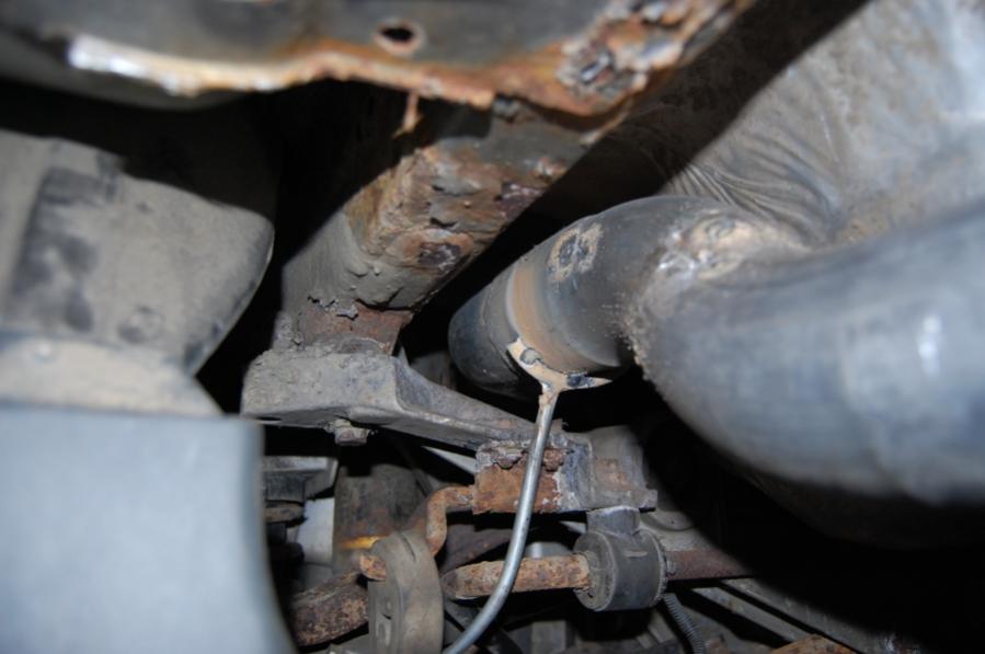

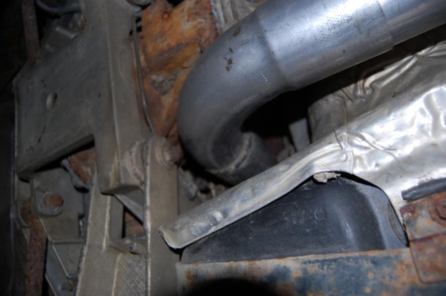

Update...And we're done! I now have a 3 inch exhaust from downpipe to tailpipe. I was able to do it with only a few modifications to the mandrel bent pieces.
I welded a universal 3 inch catalytic converter to a hacked off downpipe. It exits to a 3 inch pipe to the rear.
I went up and over the rear axle with 2 90 degree pipes (weld these together), extending the outlet by about 3 inches. Then it goes into a 45 and out to a zigzag section made from one 90 (weld these together). The offset inlet and center outlet muffler exits very close to center of the bumper cover opening.
I made hangers and welded them to pipes and muffler. I used hood prop rods for the hangers.
