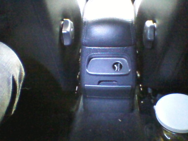

My 99 V70's rear electrical socket is detached and in the console. Has anybody ever taken one of these off? it looks like it might just pull off, but I don't want to break any clips or anything. Thanks, and sorry about the quality of the picture, it was taken on my phone.

You may be able to reach them from the ash trey. Take that out and see if you can reach it.

I pulled the ashtray out and didn't see anything, maybe on the upper side which is hard to see, it is a pretty cramped space, so I'll try again.
Old Nov 12, 2011 | 12:33 PM
Oh yea, I remember now. You can lift up from the bottom a little and pull it out from the bottom. The top has tabs on it and if you pull it straight out it will break the top tabs so you'll want to pull the bottom out first and let the top slide down and out.

Just got it. Iit was pretty easy, there was just one large tab at the top, seemed fairly strong, I don't think it would be easy to break. Thanks for the help rspi.
