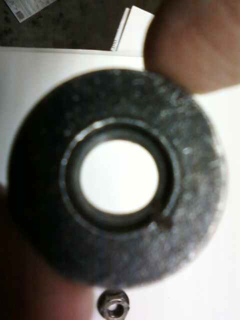

Question: I bought new bolts and nuts for the strut arm (two large bolts near the rotor), and new top-nuts for ariybd the strut tower. All the nuts were oval shaped. I figured this may be some kind of locking mechanism, but wasn't sure. While the oval shape is slight, it is noticeable when you look at the nut, and very noticeable as you try to tighten it. Has anyone seen these before?

Yes, they're just a different style of lock nut, somewhat squashed.
