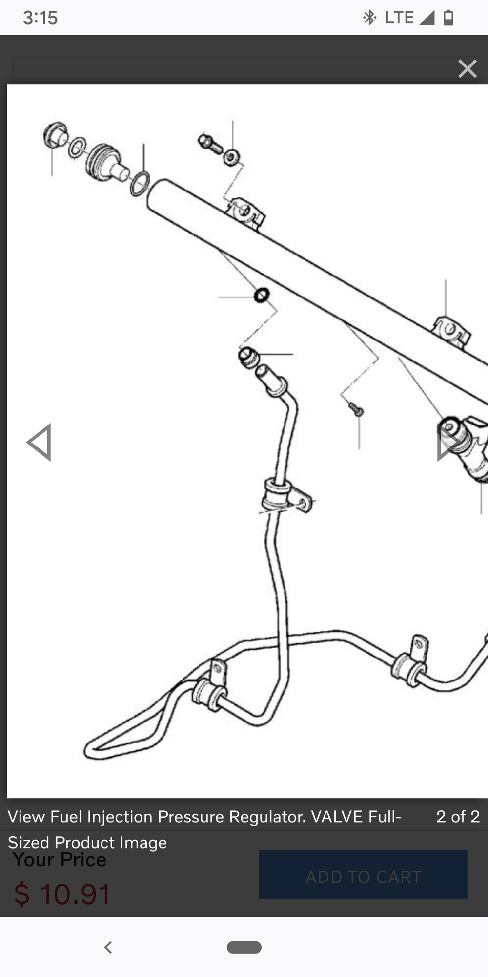

Anyone know how to replace the fuel pressure regulator on the fuel rail of a T6? Not the sensor, but the regulator. It looks like its pressed in???
Old Oct 16, 2022 | 11:33 AM
That engine has only one fuel line going to the fuel rail - meaning it's a non- return fuel system. The fuel pressure regulator is part of the fuel pump. Can you post a picture of what you are trying to do?

Looks like I'm trying to waste my time, lol. Even though Volvo describes this as a "pressure regulator, it appears (after further inspection) that it is a test port. Far left of the fuel rail. Having violent stumbling on hard accel, and misfires at start-up. Codes show all cylinders misfiring, and I can feel it. Lasts about 15 seconds at start-up. I'm going to replace the fuel pressure sensor, assuming it may be feeding the ecu with misinformation. Any other suggestions would be greatly appreciated.
