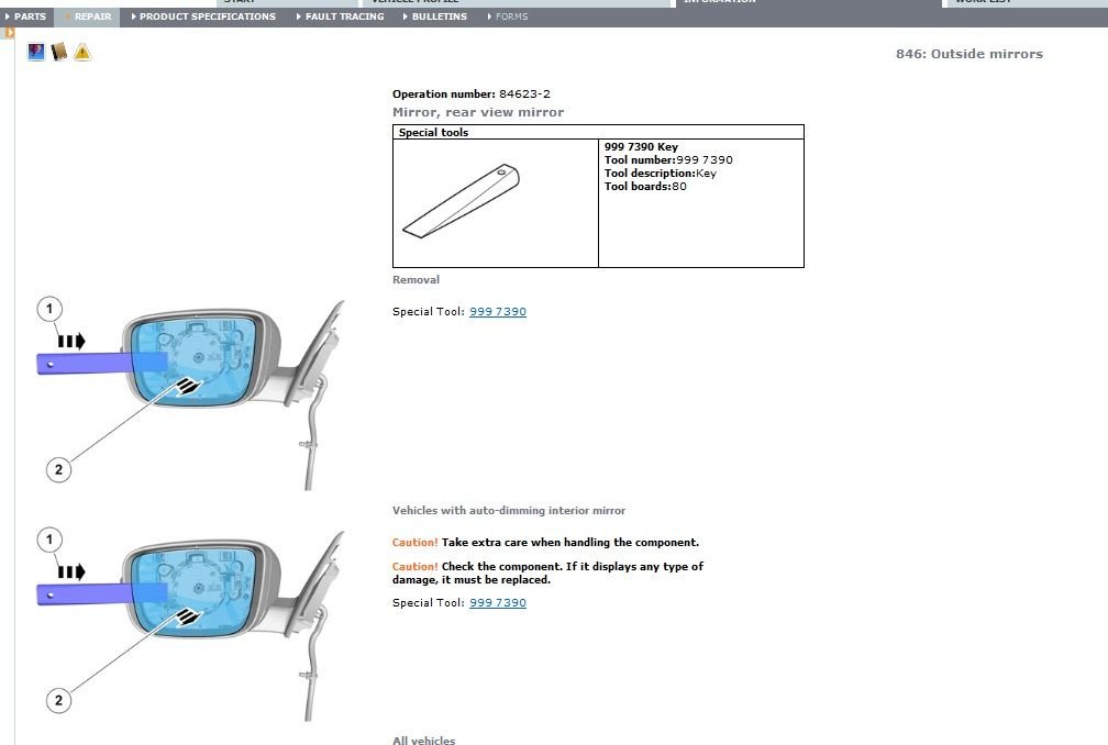

I don't have a pin out or diagram. I have VIDA 2014 "aftermarket Version" which doesn't have wiring diag's.
But after looking at the repair procedure in my VIDA, would it not just be easy to "pop" the glass out - exposing the wiring to the heated glass and the connectors on the heating element itself ? (Since I'm pretty sure that's where the problem lies") It looks much easier than removing door panels, connectors, etc.....
It's just the fear of messing with a piece of glass in the middle winter that scares me....
Has anyone else out there tried "popping" the glass out ??....

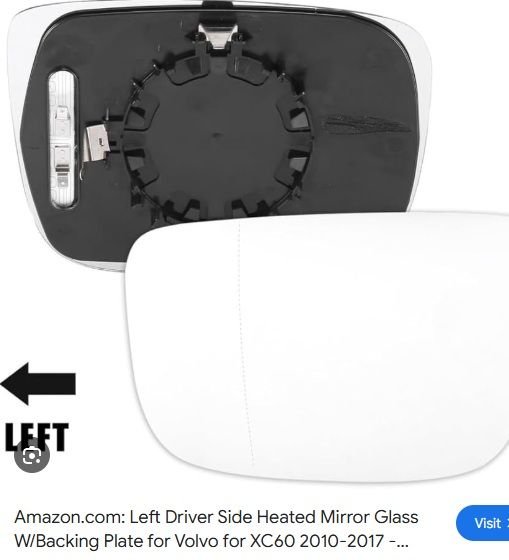

Yes, have replaced many over the years. A few different ways they are clipped to the mirror motor. Some push to the side (the mirror motor has a rectangular face). Some are clipped to the round motor face. Tilt (push/slightly pry) the glass down to figure out which you have. Vida seems to think yours is the push to the side to release kind - (i just gently use a screwdriver on those) However when the part number is googled - it shows the round plate where the glass is held on with little clips that are easily pried loose with a small screwdriver.

Pics agree with what I see on my VIDA.
Thanks to both of you for responses. I'll wait for a slightly warmer day and give it a try.....
