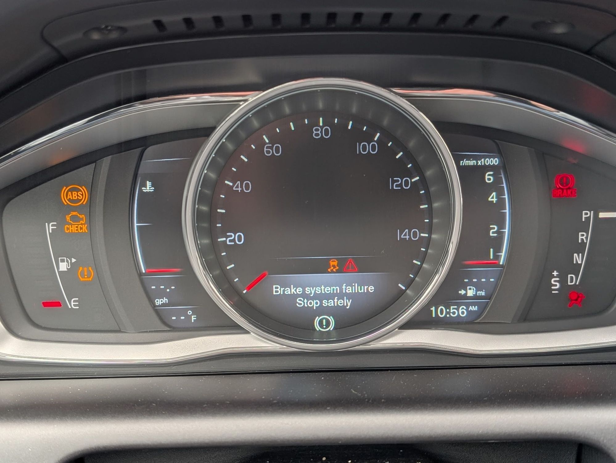

Default Anyone solve this problem?
I have a 2015 xc60 that I just purchased a week ago and 2 days after owning it I have this same exact problem occur 4 times now. Just wondering if anyone solved the issue?
Thank you
Old Feb 18, 2025 | 07:50 AM
  #29
Mrclean85's Avatar
Joined: Feb 2025

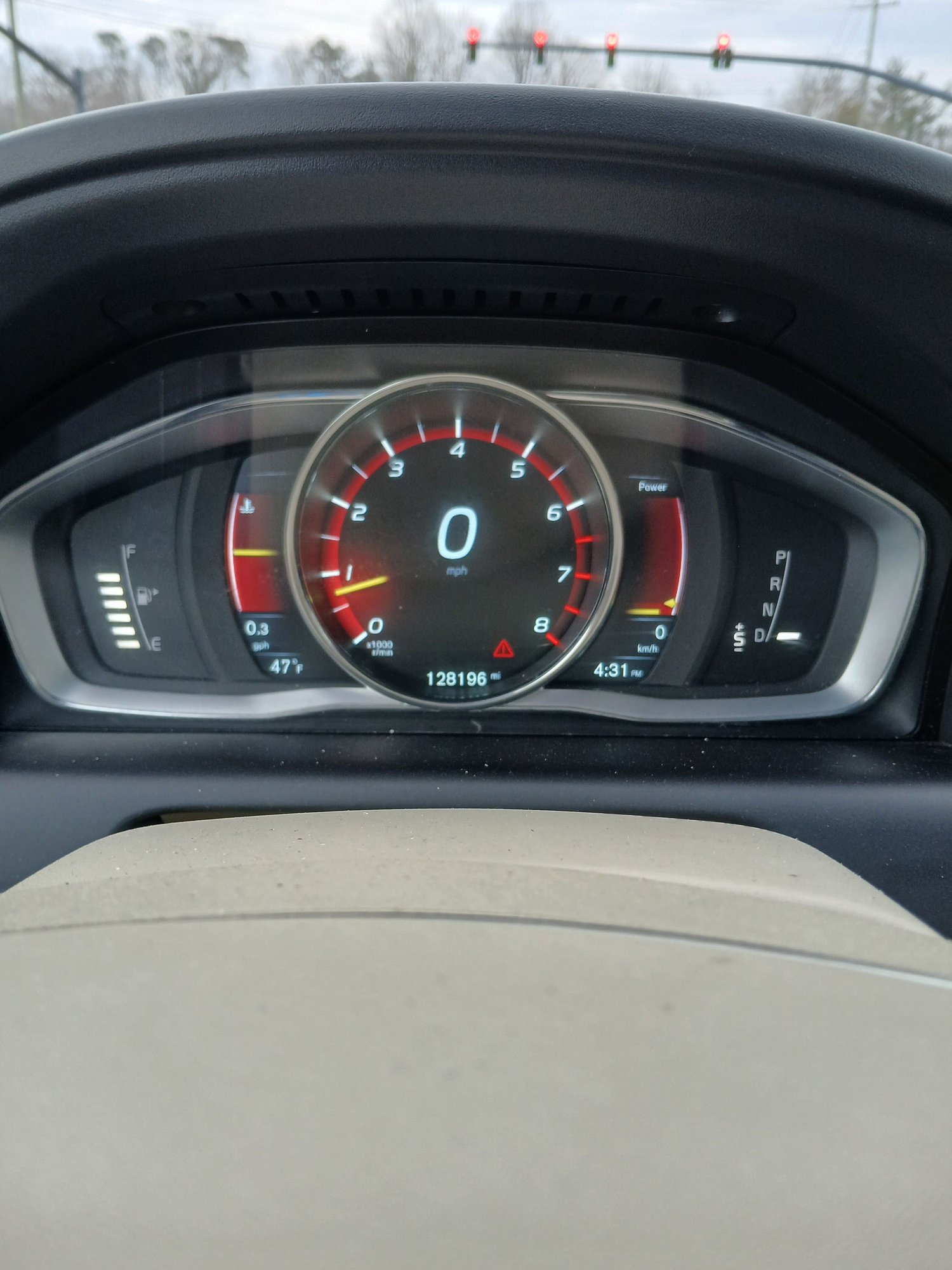

This is what I have.
Old Feb 19, 2025 | 06:14 AM
