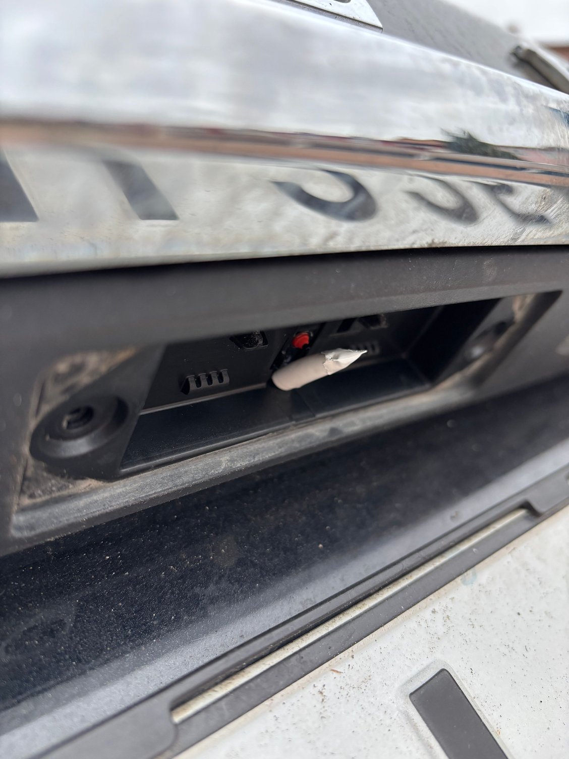

Added some extra tape to the spring pushing the opening button
Looks like more tension on the cable than it is, but seems to work flawless, past couple of days <img src=" class="post_inline_image" data-size="2000x1504" data-src="https://cimg1.ibsrv.net/gimg/volvoforums.com-vbulletin/2000x1504/img_7198_00f288aab1bec7f379d836796fa6eb804b49c130.jpeg" loading="lazy" />
Btw my car-fixing skills are zero to none, but happy I had to courage to try
gl everyone!

I DMed you, can send some pictures of the process! My experience is that the boot unlock every time you press the unlock from the outside button now, as before the “repair” I had to press 30-100 times before it maybe responded once.
EDIT: I normally don’t use the other buttons to open as I load/unload strollers every time I use the car, but surely it will fix the issue with those other two you mentioned as well
