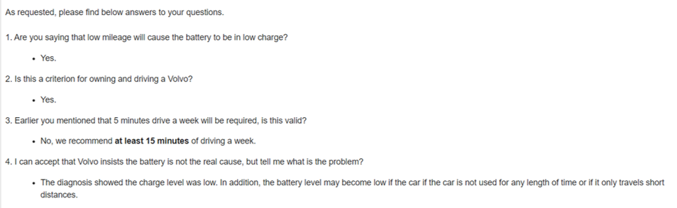

my car mileage is now approx 5700 miles (10 months use). I personally do not really accept such excuse from Volvo...
if the recommended driving is 15min a week, let's say we use an average speed of 60mph,
15min a week is merely 15miles, and a year would be 15x52 = 780 miles

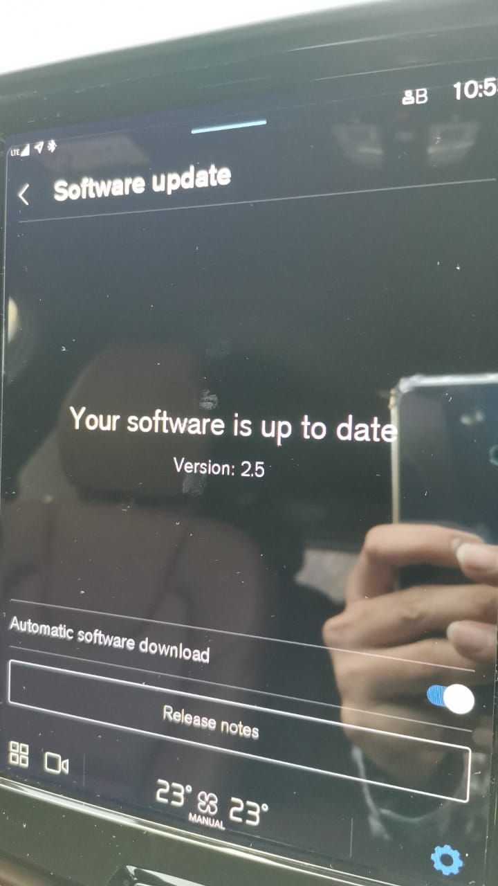

Hi all, i sent over my Volvo XC60 B5 to the service centre yesterday. The technical consultant acknowledged the root cause should have been the TCAM battery that is draining the car battery. The software should be version 2.5 now, which should be intended to resolve the software glitch that drains the battery. Also, there is frequent car network signal lost issue, to be tackled the same time. They have called me up that the car is ready and i will be heading over. That's all the update for the time being, so if any new member were to encounter the same issue, perhaps it's the software glitch that causes the TCAM to draw the power from car battery and eventually drains the battery and makes the car dead.

Finally got mine back with v2.5 software installed. They said they charged the TCAM battery and drove it, problem solved. Let’s hope!
There does appear to be new battery saving functionality as I got a message on the dash about needing to start the car to have the infotainment system turn on. Never seen that before.
The release notes say OTA updates are not available for the B5, however, just to be safe, I disabled automatic downloads under the software update menu.

when confronted with Volvo on the matter, their response was,
"your car is having a low mileage, the battery state of charge is low"
they claim if i don't tend to drive 12,500miles a year, i'm not a worthy Volvo owner.
(NOTE : in earlier message, low mileage = less than 12,500 miles a year)
