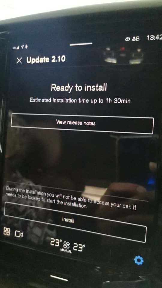

seems that version 2.10 is now available OTA, pretty fast considered i just installed 2.9 not too long ago
