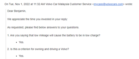

Good to come to this forum seeing the same problem is happening and not only to my Volvo XC60 B5.
Day 1 - I drove 200miles away from home for a vacation
Day 2 - Drove around 30miles within that town, parked the car at around 9pm
Day 3 - 8am, wanted to load my luggage, surprise that i couldn't unlock my car, called their Support Line and they sent a tow truck to bring it to the nearest service center
Day 4 - got the car back, was told "no problem with the car"
unpleasant experience stranded 200miles away from home.
when confronted with Volvo on the matter, their response was,
"your car is having a low mileage, the battery state of charge is low"
they claim if i don't tend to drive 12,500miles a year, i'm not a worthy Volvo owner.
(NOTE : in earlier message, low mileage = less than 12,500 miles a year)
