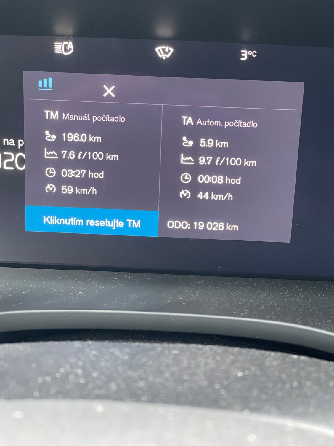

  • The auto trip computer doesn't reset every 4 hours the way its supposed to. It resets, but it does so on its own schedule.

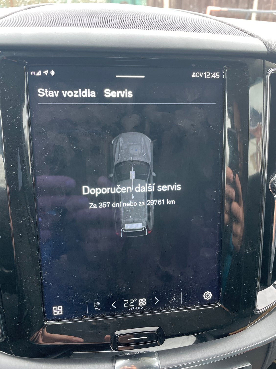

Default 1.8 problem
As you can see on the pictures, there is a problem with servis by the new 1.8 actualisation ,synronisation of km for next service, i hope by next will it be solved

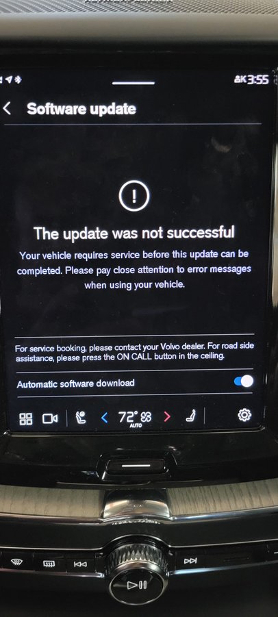

​​​​​​Wonder if this happened because I had so many issues with 1.7. Fortunately, I have a service appointment on the 27th which I booked 2 months ago because of the problems I was having with 1.7. Now they can deal with 1.8 as well!
was your dealer able to clear this error? If so, do you know how? My 22 XC60 is in the shop right now with the same error. They do not know how to clear it?
thanks,

Old Feb 11, 2022 | 10:25 AM
Ooo.a.volvo's Avatar
Joined: Nov 2021
Posts: 19
Likes: 5
From: Georgia
Spent almost 2 weeks at the dealer but it finally got resolved. When I went to pick it up they said they had to wait to get the software from Sweden.
