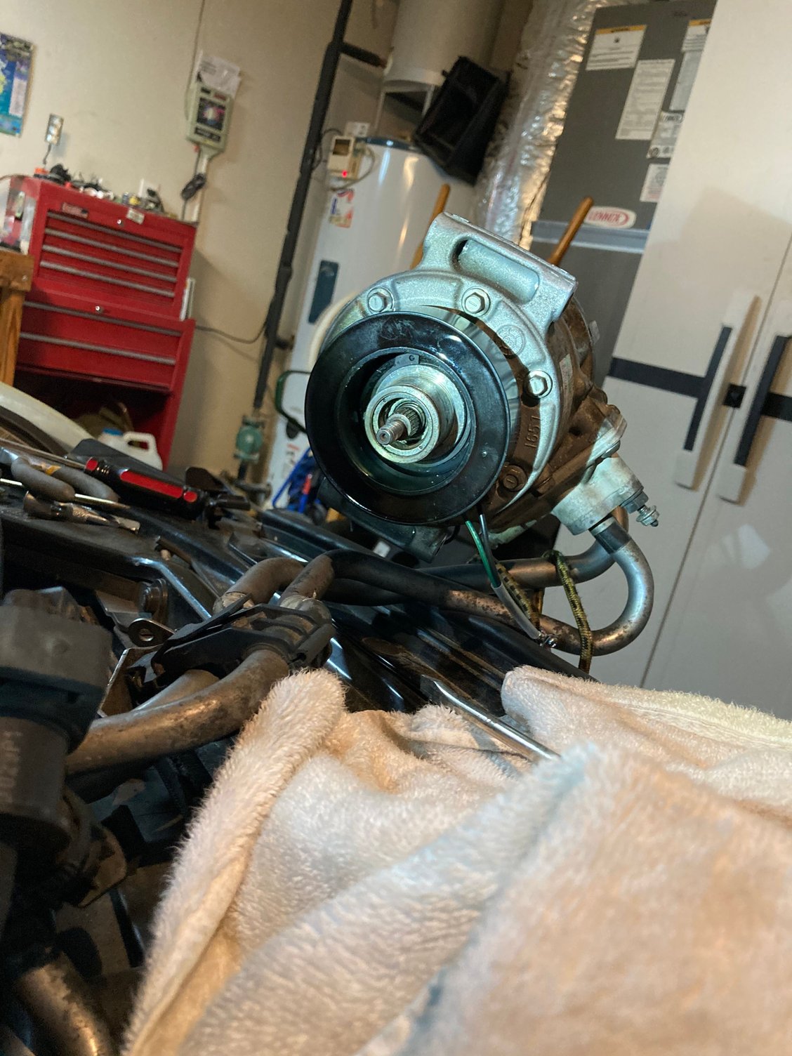

Just replaced the Solenoid clutch from VolvoPartsWebStore.com. Contact them with your VIN and get the correct part number for the one installed on your car.
I tried to installed a refurbished clutch from a independent company that said the one they had would work. It did not. Was close in dimensions but it was different enough to not work.
If you are a DIYer with some patience it can be accomplished in a day .I had removed a shim a year or so ago to get it working again, but this time, the clutch face was worn away so that a section of metal delaminated and the contact required no longer happed. Some pictures from replacing the clutch.
Notice the delaminated ring of metal
Compressor installed location
Old clutch face on top, new one on bottom
Remove a bunch of stuff to get the compressor out far enough to work on the clutch. The belt tensioner is probably the hardest part. Look on youtube for that. 3mm allen wrench to hold it in the locked open position
You have to get at the c-clips/snap rings holding the coil magnet and the pully hub on the shaft. They are a bear. Tried to get them off for a long time before finally getting the compressor out this far to really get good access to the snap rings.
Have Cold AC again. Compressor works fine. Compare the cost of $750 for a new Volvo compressor, plus Freon charge, etc. versus $250 for a Volvo Clutch.
