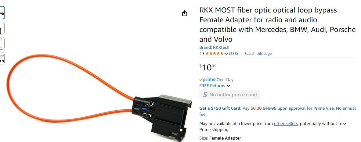

Yes, RDAR is is satellite radio module.
If you think that's causing the problem (or want to believe your service provider) you can simply take that module out of the system. Purchase and install a compatible "most bypass loop"
to bypass that module to test their diagnosis.
A recent thread showing the location of RDAR can be found at
https://volvoforums.com/forum/volvo-...t-dead-117416/
