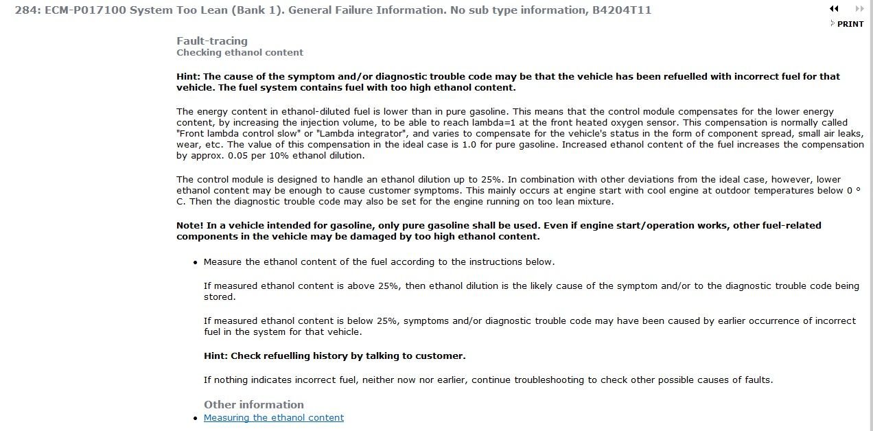

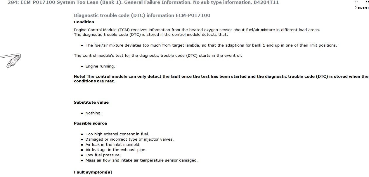

Old Sep 15, 2024 | 07:30 PM
Here's some suggestions from Vida as to why you keep getting a 171 code
