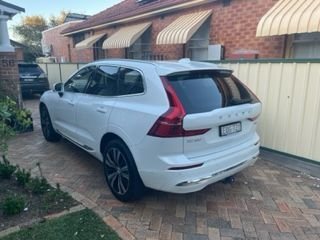

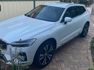

Gidday everyone,
Just got a 'new to me' 2022 B5 Inscription I love every part of it except for 2 aspects. the ride on the 20's (coming out of a 2010 RX450h so tough comparison) and the basic Audio system controls (there is no balance or fader control.
So 2 questions, has anyone put 245/50R20 on their Inscription's? it makes about 5ml difference in sidewall height and 2.5KPH in at 110K, so fairly inconsequential. But did it make the cars many system go banana's? Did it improve the ride?
And secondly can Volvo, if they see fit, change the stereo settings with a software update? has anyone heard anything if so?
Don't get me wrong I am 'over the moon' with my choice. It's a far more driver orientated car then the RX and was literally the only vehicle I drove that excelled the luxury feel of the interior. The Napa ventilated seats are amazing.
just back from 35%ceramic tint, looking a bit gangster
