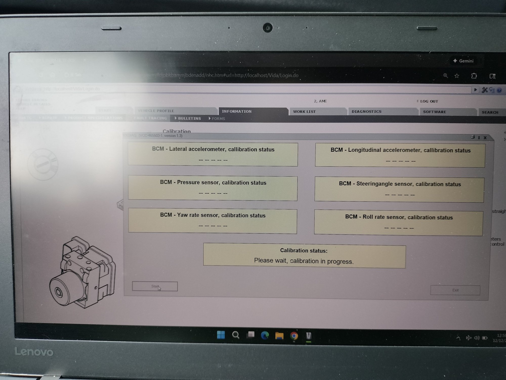

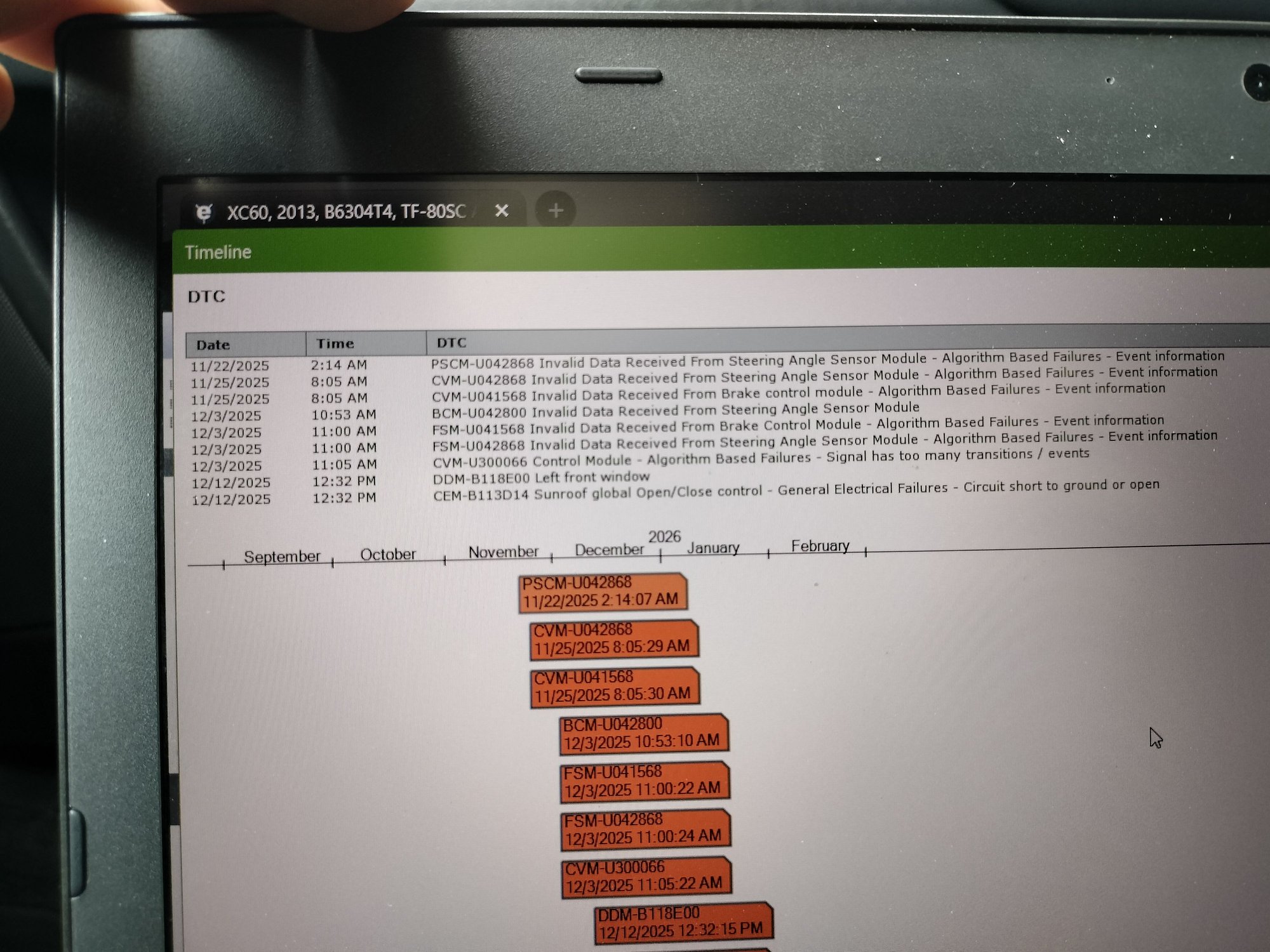

So we had the steering rack replaced and no codes previous to that and after work was completed and we got the vehicle back we had a bunch of lights dstc inactive etc. I figured maybe steering angle sensor was an issue from the codes I pulled in Vida but that hasn't helped me out as I cannot calibrate the sensor without errors. I'll attach images with information if someone could be so kind as to help a guy out. The original sensor had the same failure while trying to calibrate it as well. Could this be as simple as a plug that wasn't reconnected securely? Or another calibration process I am unaware of? I am using a VxDiag VXC SE as my interface

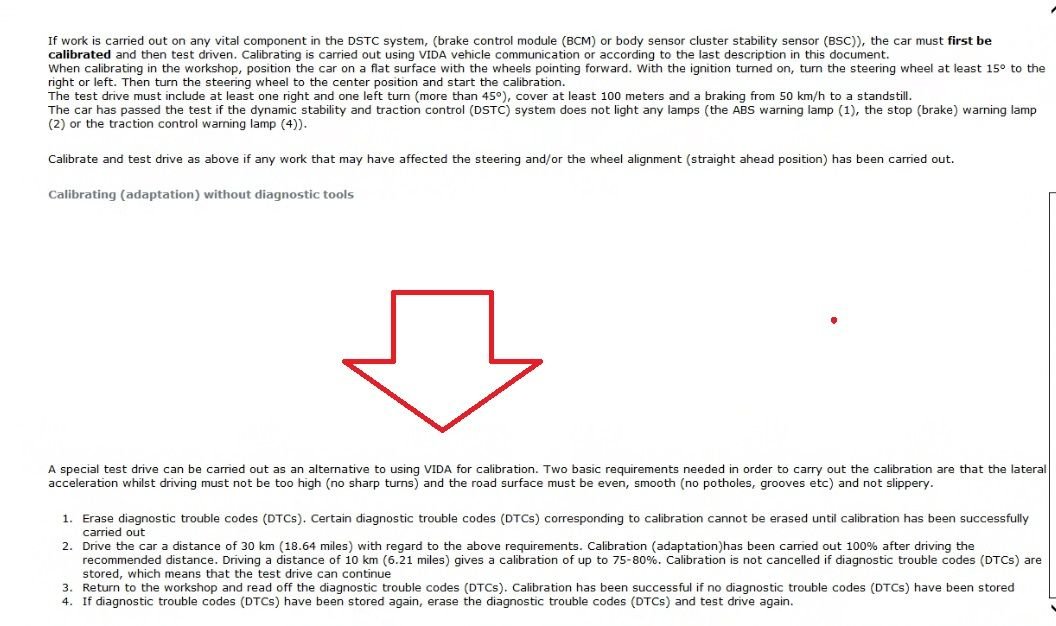

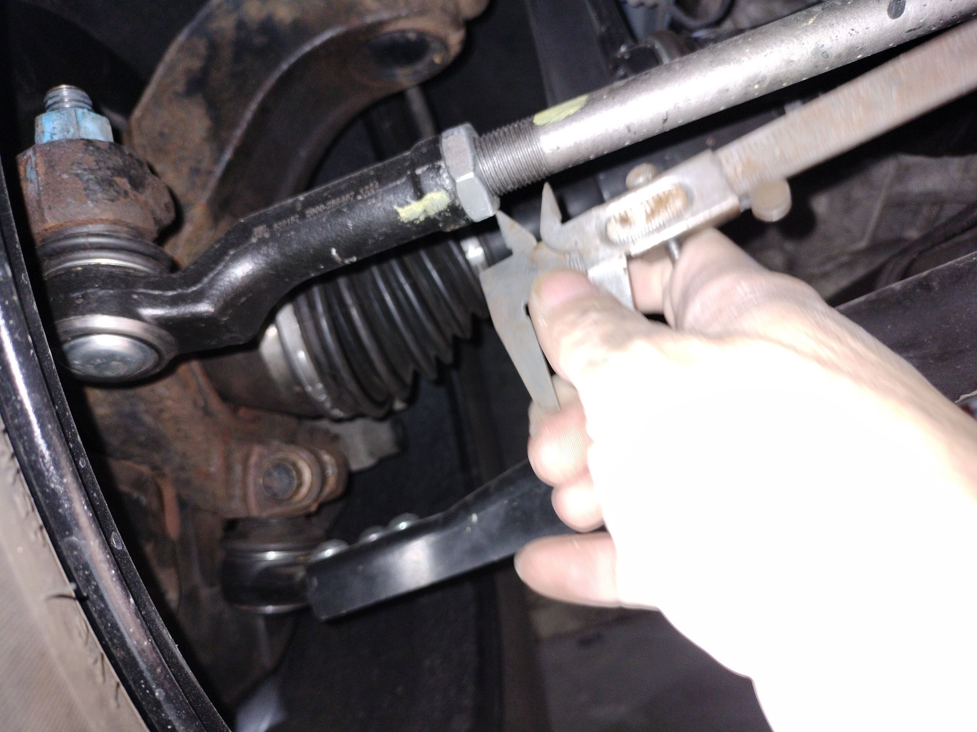

Perhaps the tie rods are not the same length and that is preventing your calibration - and I trust you have seen the page showing how to calibrate without using VIDA. Or the steering rack was not exactly centered along with the steering wheel when the the steering column u joint was connected to the rack.

I did try the simple calibration method without success that's why I used vida. I have a vcx se from vxdiag I used I have a aezflasher 3 also just haven't tried it yet as it's been loaned out. The tie rods will get checked as I haven't came across that info, thank you.

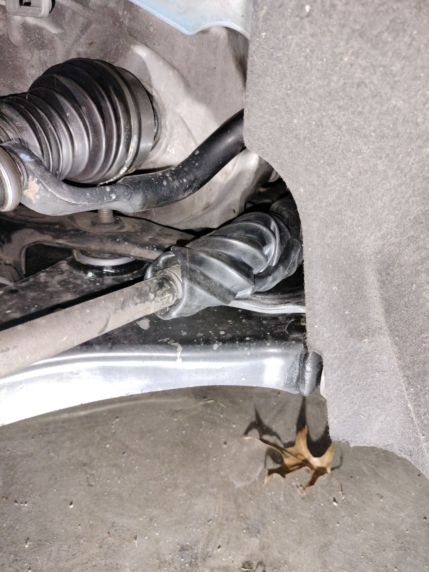

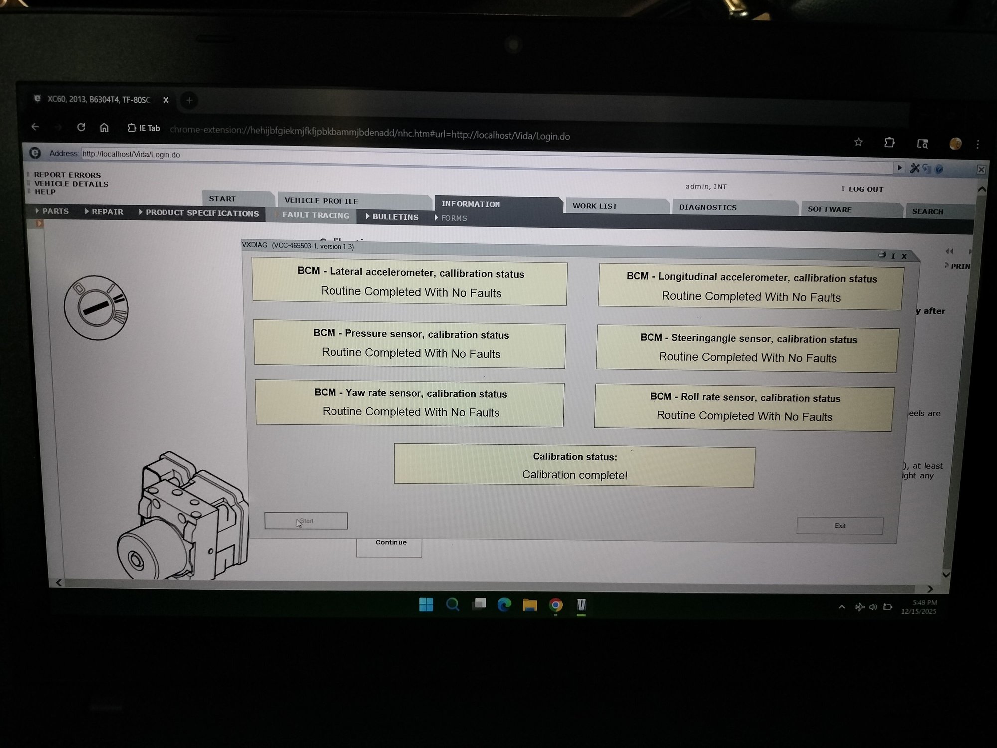

So the steering wheel indeed was 360° off from center after fixing that calibration was indeed successful. Luckily I could hit the u-joint at the pedals and not have to get under the car. That said I haven't adjust these tie rods yet which are obviously way over the allowed 2mm allowance. I was curious to see if it would calibrate before correcting the tie rods and it did.
Yes, it was completed with the boot twisted like that and given back to us....
