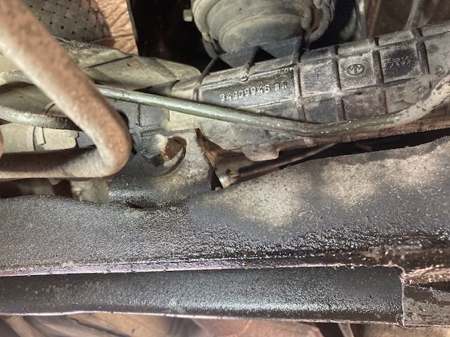

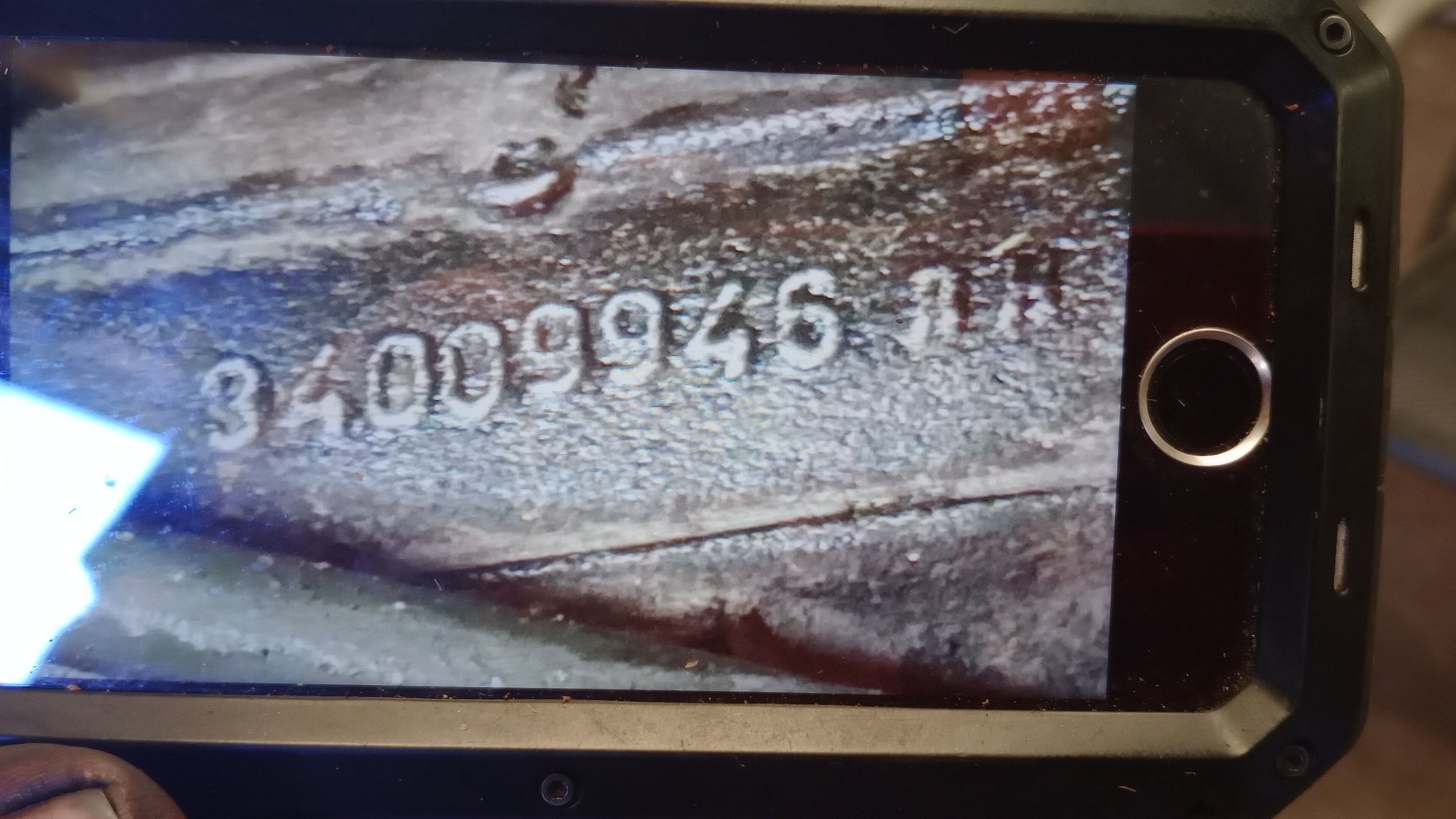

Is this the part number as its all i can find
Can anyone tell me what this says as i cannot get a rack without supplying part numbers and there is no plate where the column meets the rack with info on it. Thanks

Yes that is the part number - the two characters you may be having trouble reading look to be "RH" so I'm assuming you have a RHD 850... kind of important for a steering rack :-)

Volvo part number that I have for an 850 is 5003968 - Supersession(s): 5003815; 8251305; 9140421
