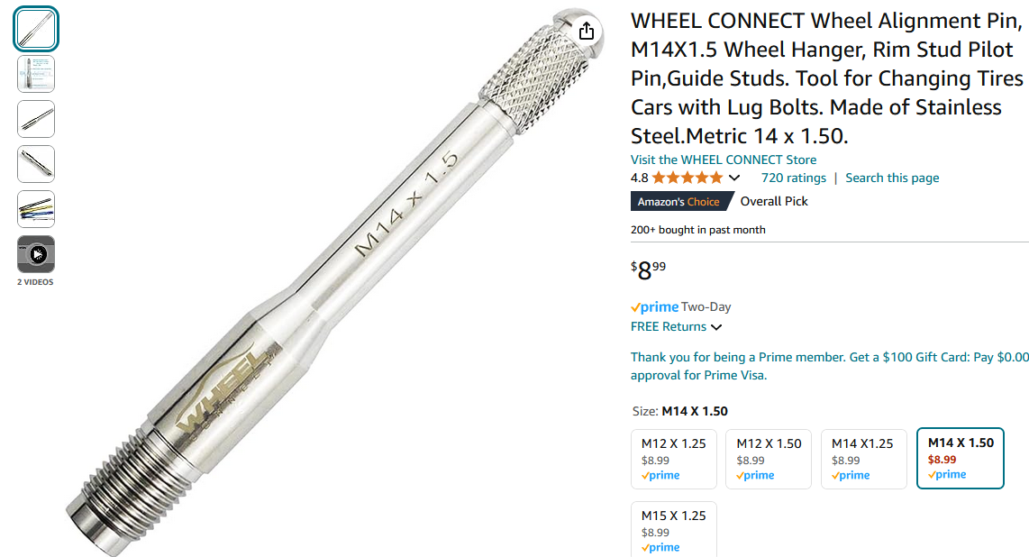

Buy some M14x1.5 wheel alignment pins like these (1 works, 2 is better, easier):
Linky Linky

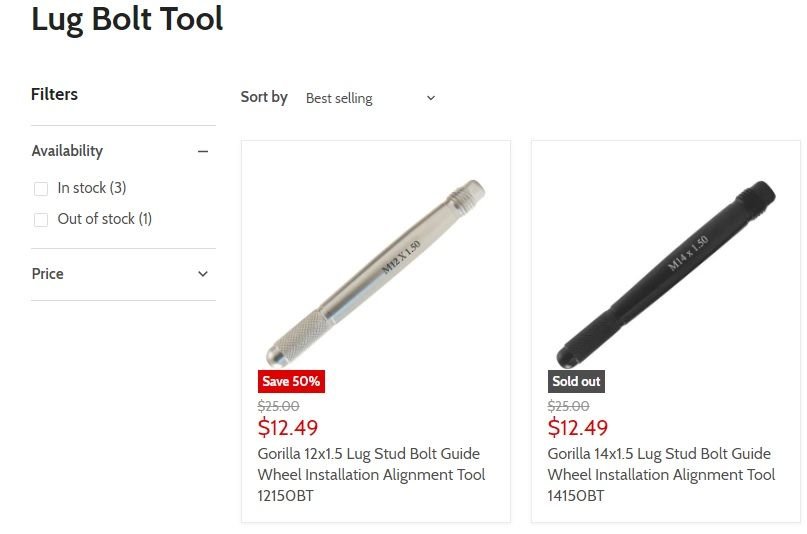

Yes - it can be difficult to line up the bolt holes especially when tire is barely off the ground - much easier when car is on a lift.
If it's a problem - you buy a tool designed to help
