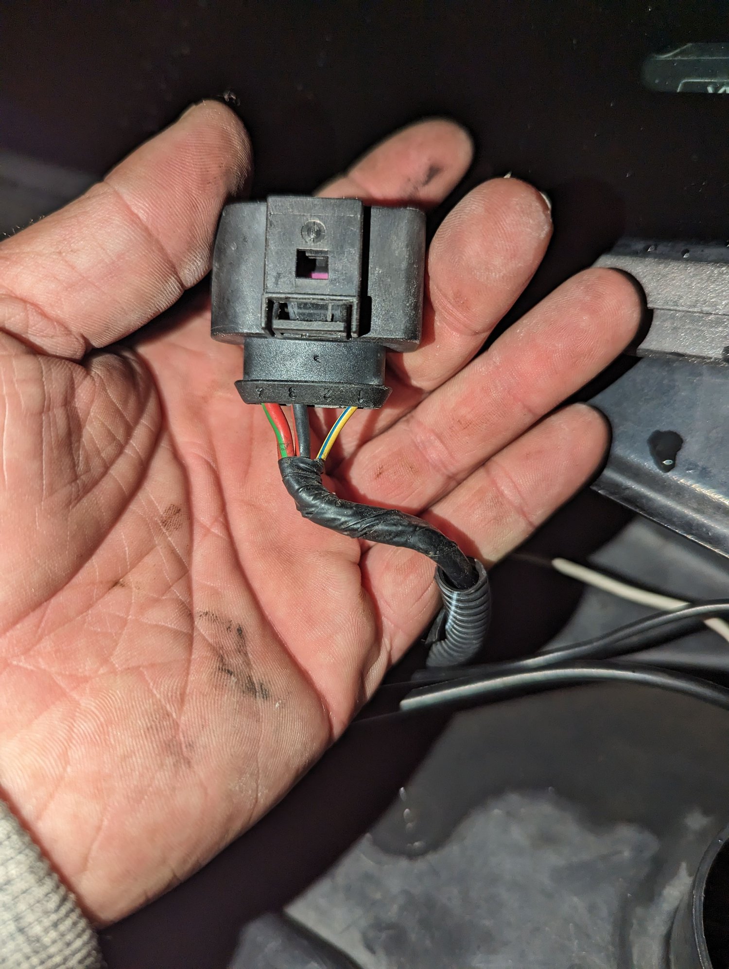

I have power going to the 2 outside wires on the wiper motor plug, that power doesn't change weather or not the wiper switch is on or not. When I removed the wiper fuse I lost power to one of those wires. ( not sure if any of that is important just might be useful information)

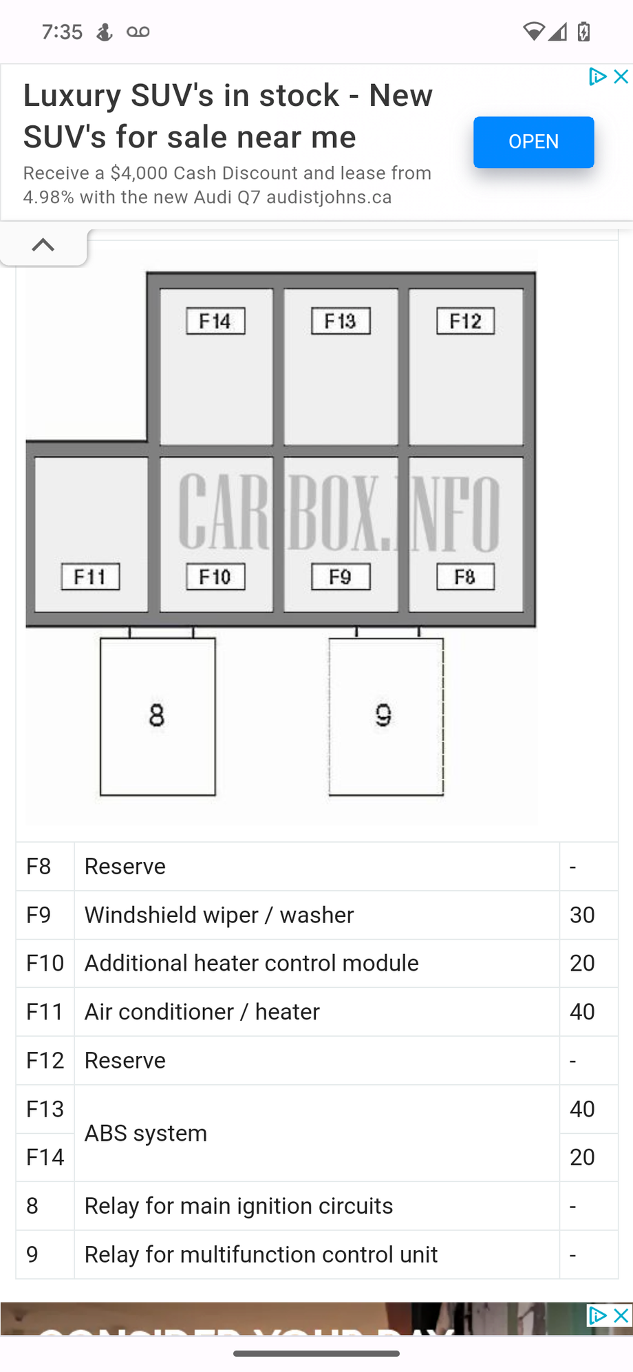

Is there a wiper relay that I can not find (haven't found in any of my research) , I have found a "multifunction control relay" under the main engine fuse panel (location 9 in image)
I'm out of ideas as to what to try next besides replace the multifunction relay in hopes that is my wiper relay. Please help lol

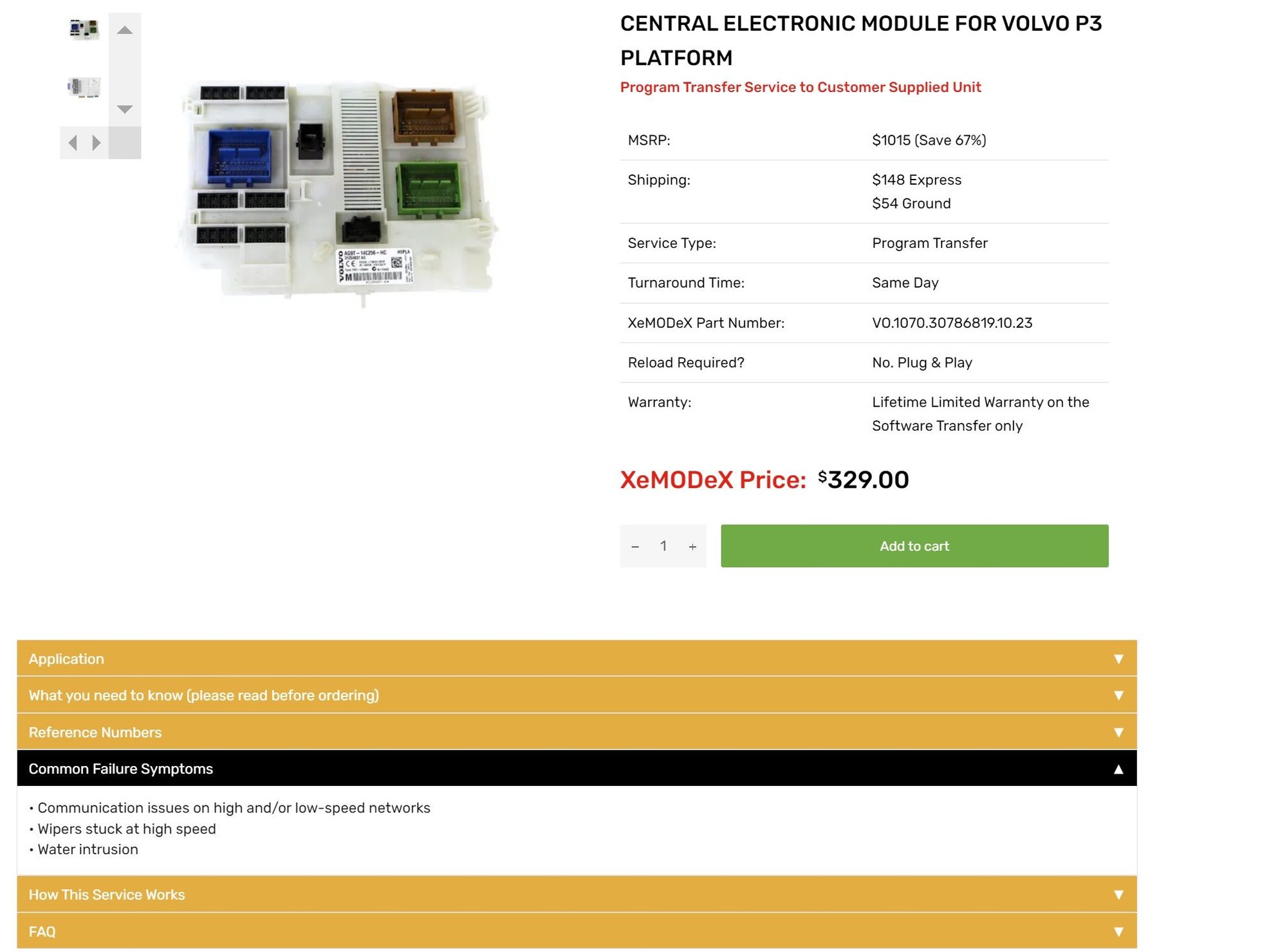

xemodex seems to think wiper problem can be caused by the CEM.
