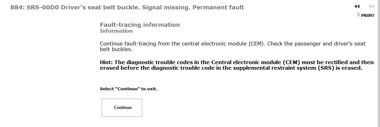

Went back to shop.....0D00 left ( driver) seat buckle signal missing resistance too high....pulled seat, measured continuity ...so far that checked out but one wire I couldn't get a Reading on .guess it could be the buckle itself but either way I have to find the culprit and so far my continuity test hasn't solved it.I am told through readings it won't keep air ags from being deployed? Gotta fix it either way!

That's what I hear..... So question is can a scanner w SRS do this or only vids/ dice?

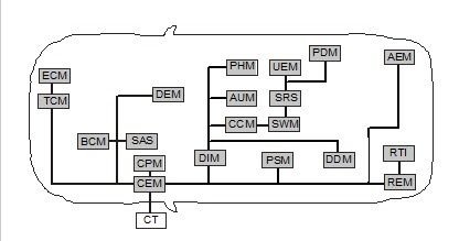

Old Mar 26, 2024 | 11:56 AM
There are many compatible scan tools that can talk to the CEM other than VIDA/dice.
A compatible scan tool is able to read and erase codes from all the modules in the car (if installed, you probably don't have a RTI road traffic info module or PHone Module, as well as a couple of others)

Yeah only thing I am weary about is " permanent fault" ....guess we'll see when I get someone to clear the CEM
