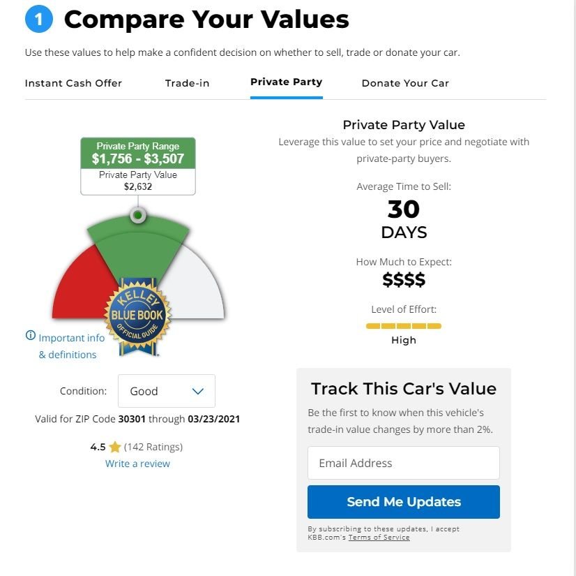

There is nothing else wrong with my Volvo everything still works and it’s still in amazing condition inside and out other than the oil burning in the pistons, how much should I sell it for

Sorry to be realistic here but - your at best $3500 car needs whatever it takes to make it stop burning oil after running dry and damaging the crank/pistons/turbo/cams/everything in the engine - whatever. That is several thousand - say retail $3500. So your car is worth $0.
So, offer it first to your "friend" for what maybe $2500 - or put it on Craigslist for XXXX, and hope some unsuspecting idiot buys it from you. It's amazing what some people will buy thinking it's an easy fix.
