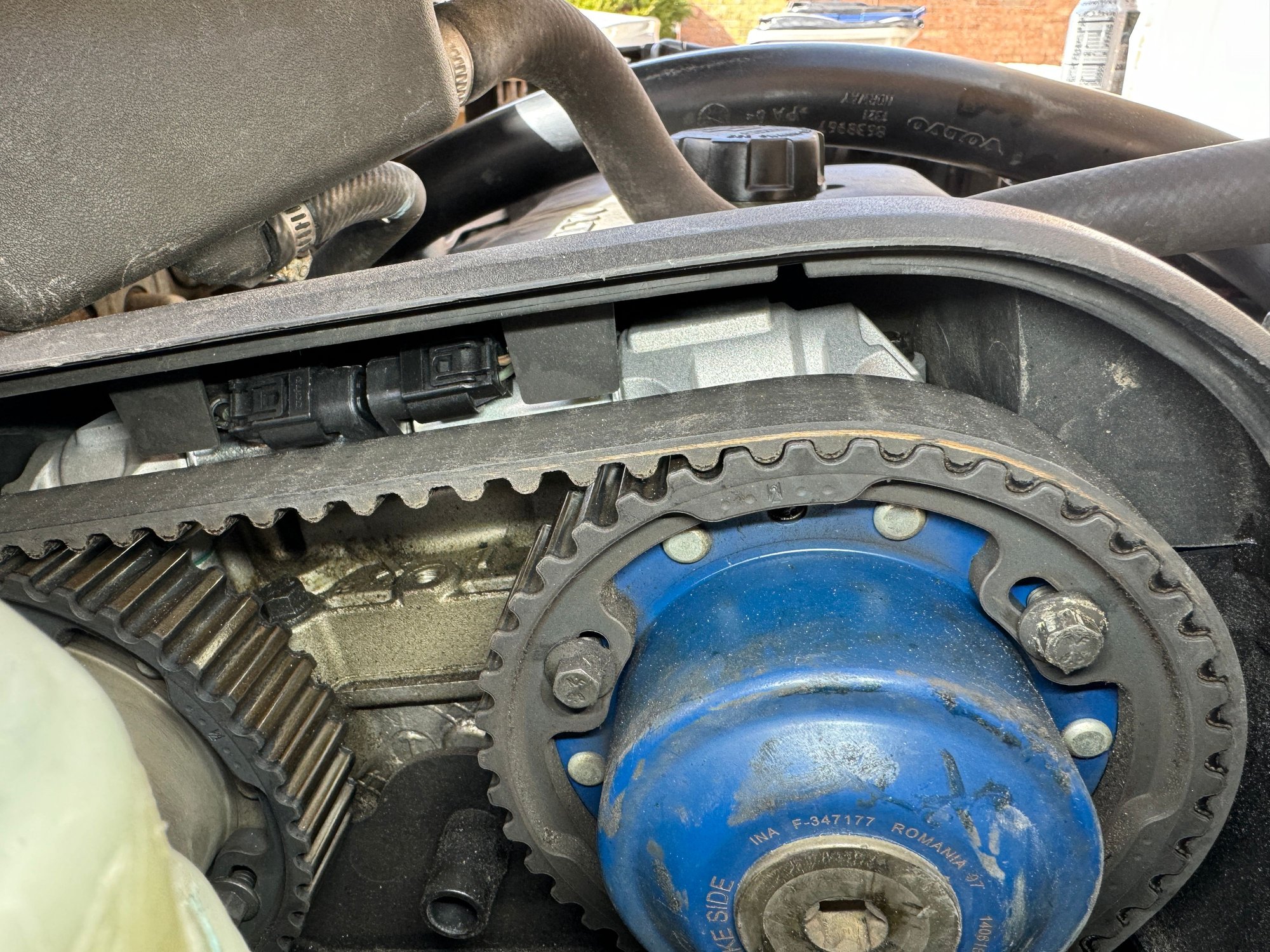

Posts: 8
To me it appears that hubs were not installed by one of the previous owners. You can see that the crank is aligned with the marks on the block and the cam markings look like they’re 180 degrees off. Thoughts?

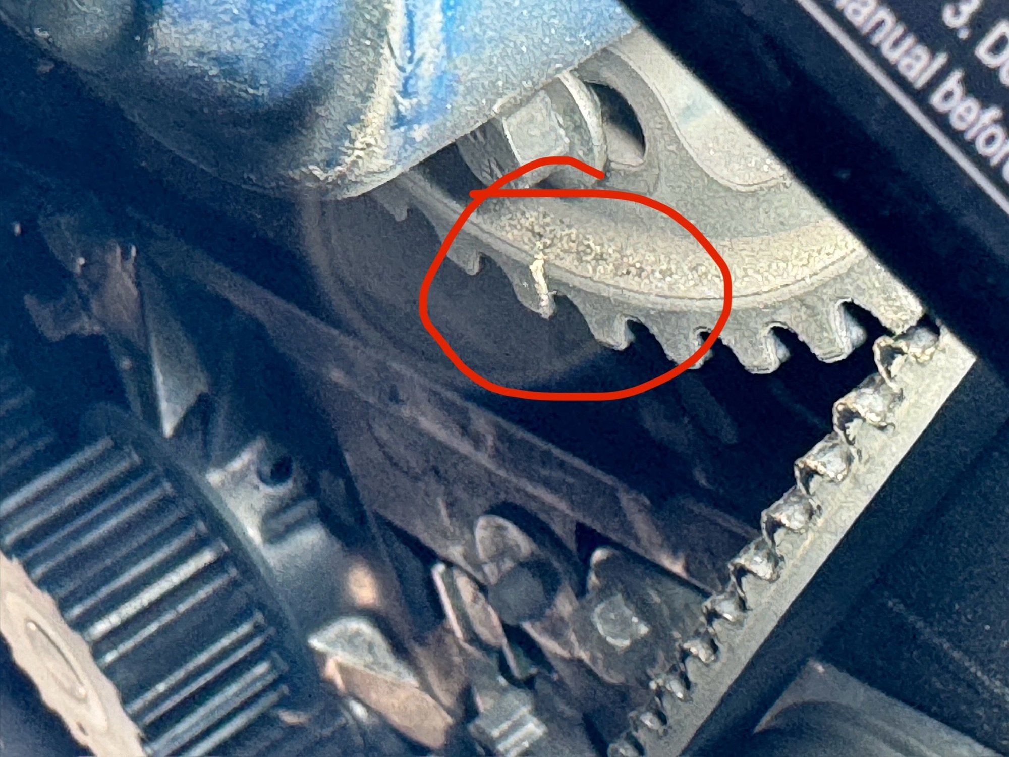

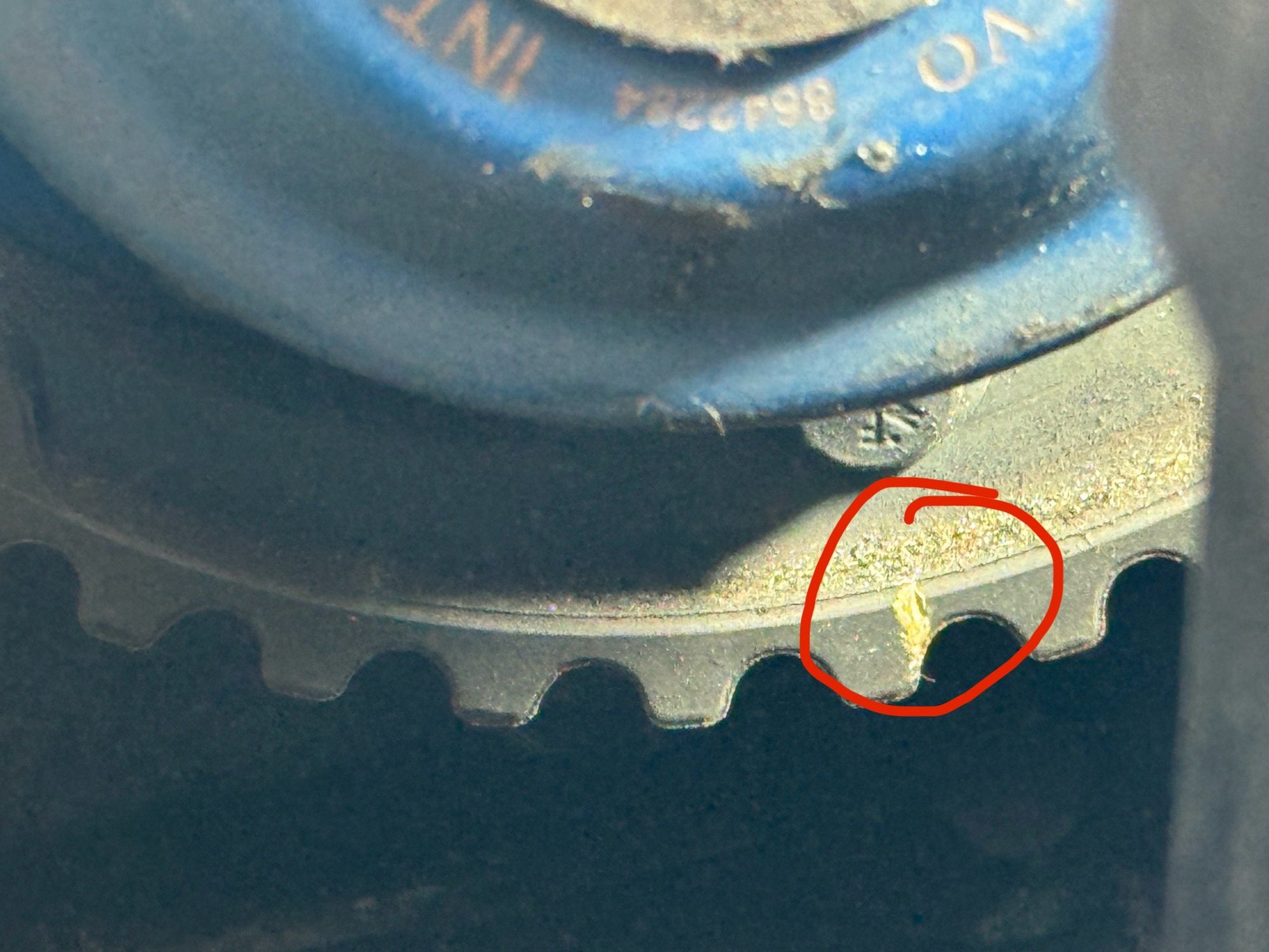

Posts: 8
Better showing of cam marking position.
