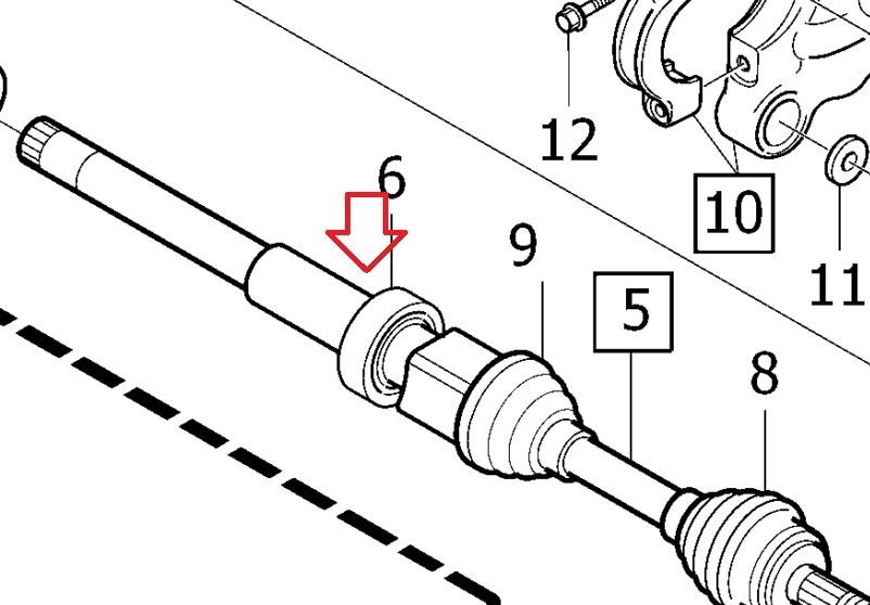

Have the front axles been replaced yet? Particularly the right one?
If the center bearing on the right crappy aftermarket axle walks down the shaft - the right axle pulls out of the trans - and the car won't move (the transmission sends power to the wheel with the least traction, that's what a normal differential does) and will grind when shifting because the transmission is shifting and spinning but the right axle has popped out -
Remove the carrier for the right axle center bearing and make sure the axle is pressed into the transmission all the way - then push/hammer/press the bearing back into place and stake it down.

The axle is too small in diameter (sure by ~002 inches) where the bearing is - allowing the bearing to move/slide. Make the axle bigger right where the bearing is trying to come off - A punch will raise/move a little bit of metal, do that a few times around the axle and the bearing can't move anymore. You don't even need to remove the axle.

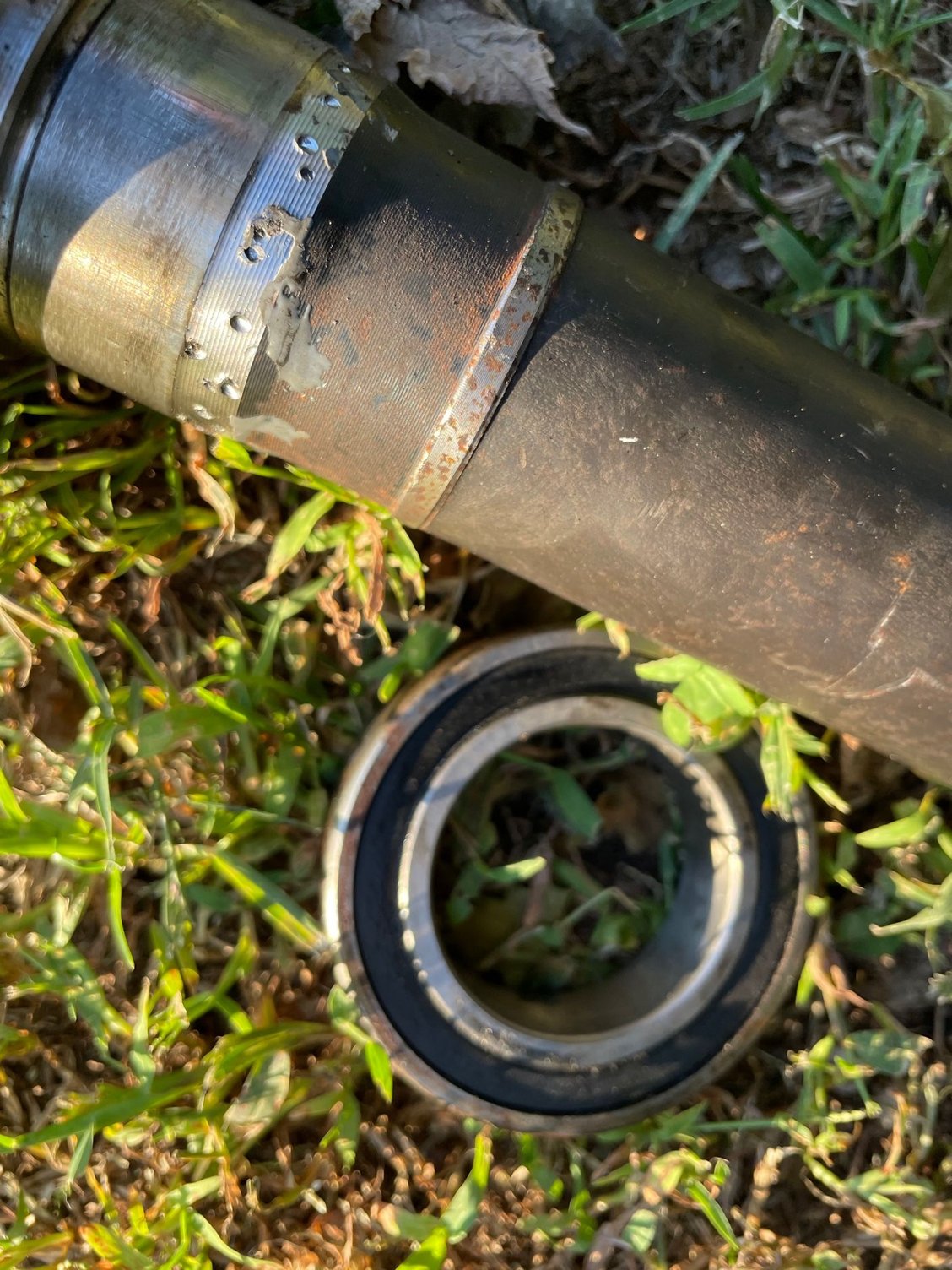

A year later and this just saved me from actually towing mine to a shop!
Mine popped out but evidently still had enough friction for the front wheels to behave correctly when they were off the ground but they would not engage when they were on the pavement. The PO took exceptional care of this car - $1,000 set of newish Michelins on a car with 230K miles on it is always a good sign- so I doubt they would put a cheap axle on it.
My question is: Could the bearing be worn from age and should I just plan on replacing the axle soon?

Looks like someone already fixed this once using your trick!
So it was off to the parts store for a new one.
